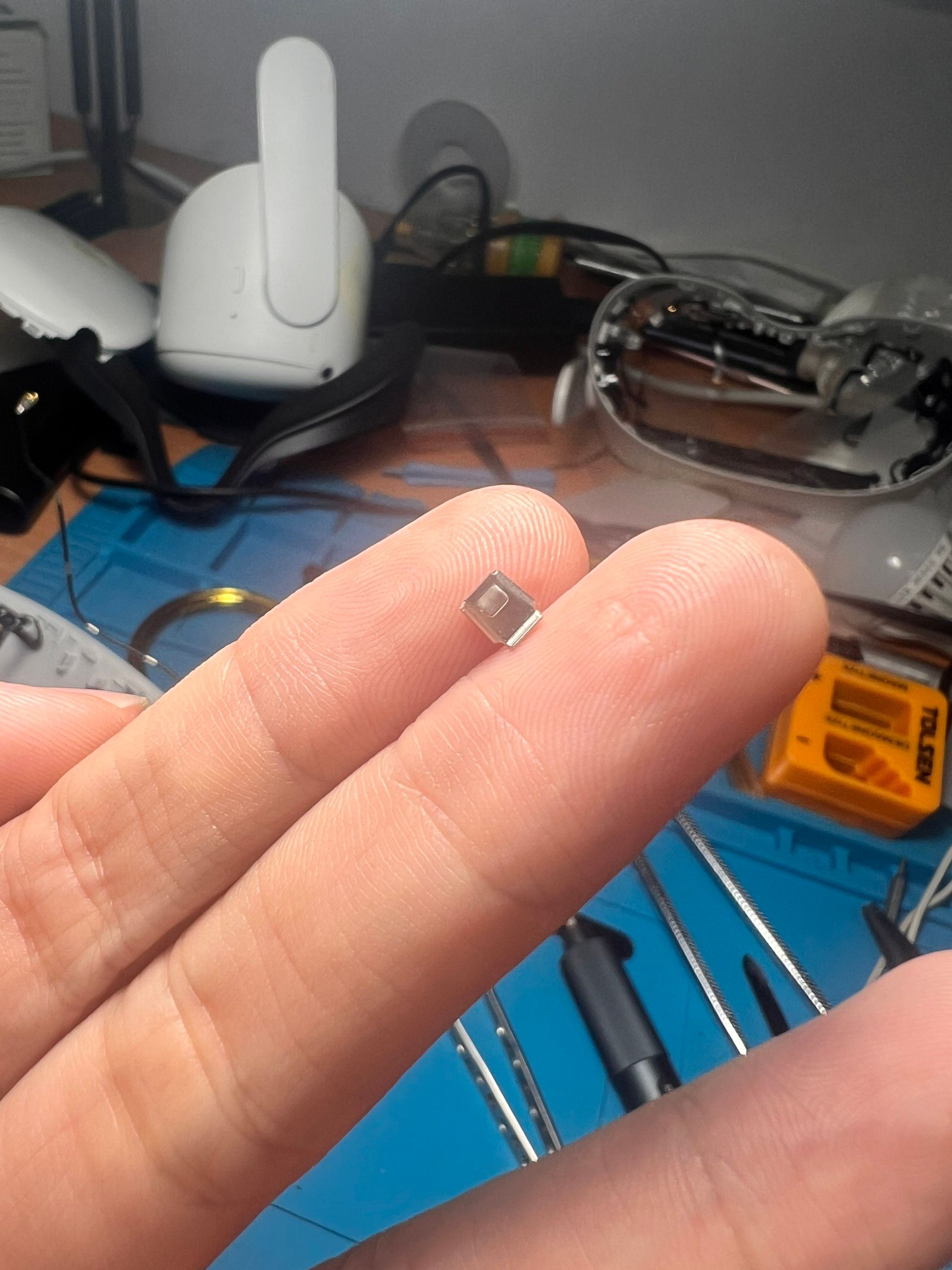

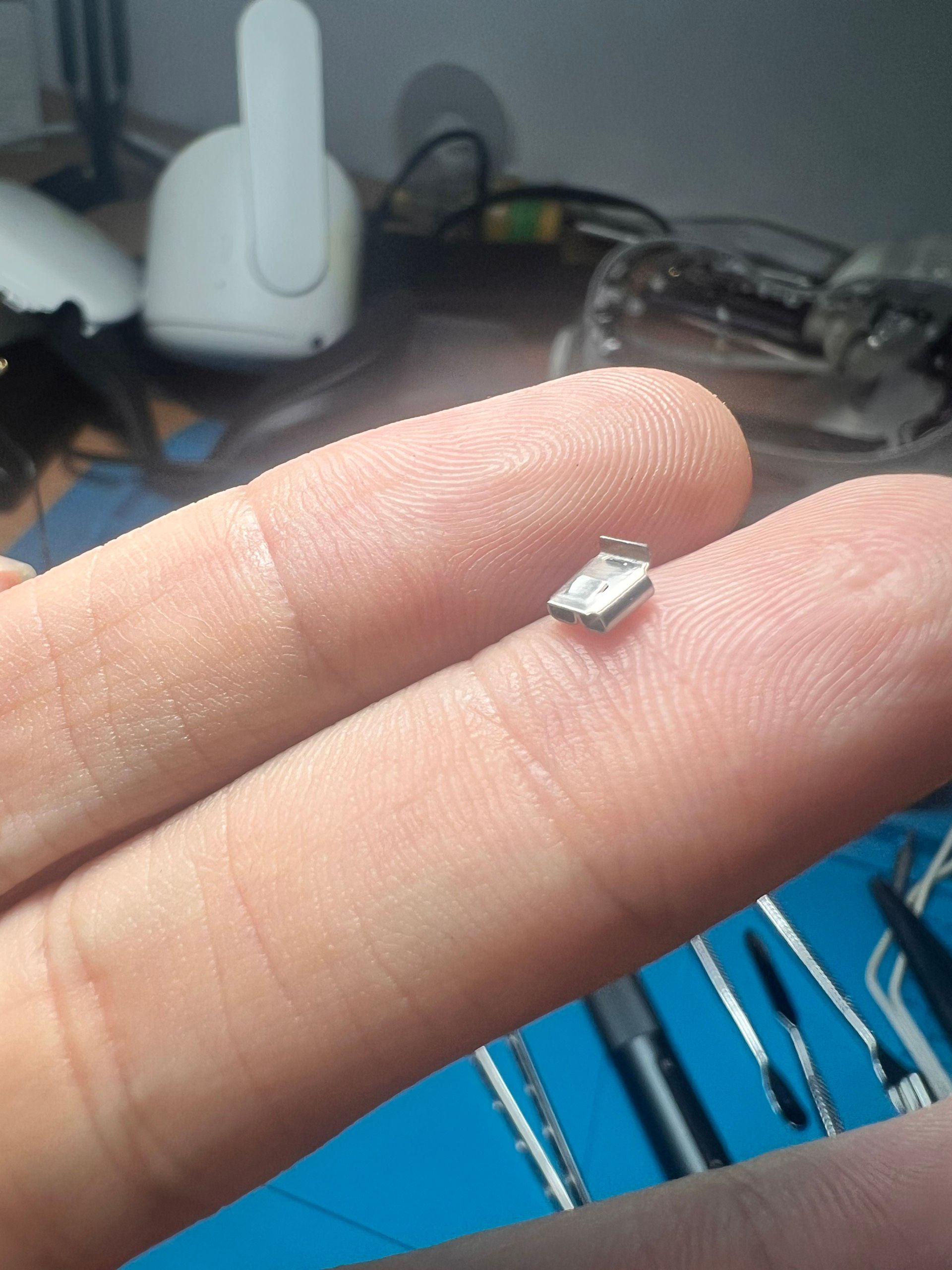

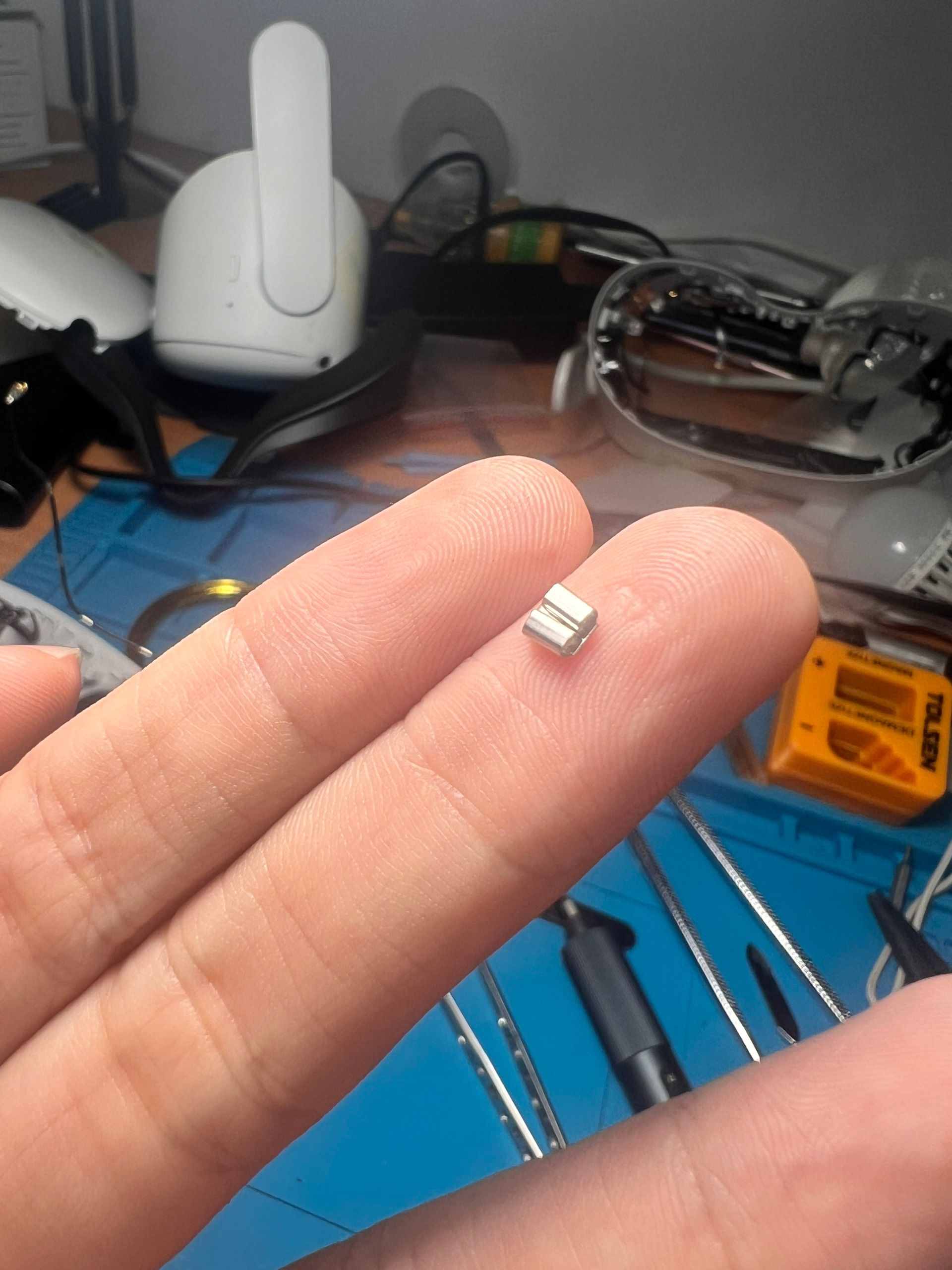

    Can someone please elaborate on how to remove the metal clips on the arms/speakers?
    Is there a special tool or technique?
    Fixxif - Responder
    Same here. I can’t figure out how to remove the clips.
    Colin Harris - Responder
    I would like to know how too! I need to replace my speaker but i doesn't find the technic for metal clip. Thank you
    Patrick Potvin - Responder
    its easy enough to use tweezers to remove the clips.
    Ben Klopfenstein - Responder
    I am having trouble removing the screws. Any tips how to get them out.
    AJ Sandoval - Responder
    for anyone still struggling, you need to squeeze in a small flathead screwdriver deep under the metal tab. that way it releases it properly. if you look a pictures of the springs you can see the little latch there on the side with the tab
    Imya Familiya - Responder
