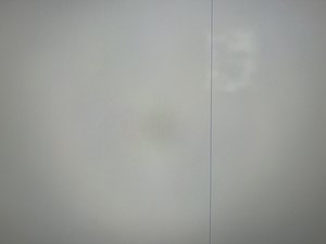

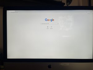

I have a Late 2014 iMac 27” (A 1419 EMC 2806, 3.5 GHz) which came with the 1TB Fusion drive.
Two questions:
1) After sitting on a desk, connected to an AVR UPS, in a temperature and humidity controlled room, and never opened, we’re seeing a single vertical line down the right 1/3rd of the screen. Pictures attached. What is this likely to be? An easy/cheap fix? I saw another person said it might be cable related? Line does not appear on external Thunderbolt Display. Wasn’t sure if we were talking cable, display, logic board, video card.

The single thread like line is one of the thin Metal Oxide traces on the glass plate of the LCD panel which drives the panel has become disconnected. We can it a TAB error Defective pixel - Tape Automated Bonding fault
Sadly, there is nothing you can do to fix this and you didn’t create it from the environment of your shop.
One way this can happen is when the wrong tools and technique is used to remove the display assembly. Going to far with a sharp tool or prying are often the cause where the glass is stressed causing micro-fractures within the thin Metal Oxide traces.

So, silly question, which part would you end up replacing to fix this? The LCD panel?
por
Also, does this “just happen” over time? We bought it new directly from Apple, not refurbished, never opened.
