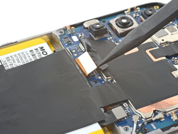

Disconnect the display
  • Use the pointed end of a spudger to pry and disconnect the screen's press connector.
