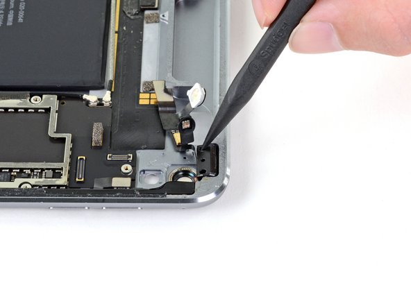

  58. iPad Pro 9.7" Power Button Assembly Replacement: passo 58, imagem 1 %32 iPad Pro 9.7" Power Button Assembly Replacement: passo 58, imagem 2 %32
    • Insert the pointed end of a spudger into the left screw hole on the power button bracket.
    • Push the power button bracket out of its recess.

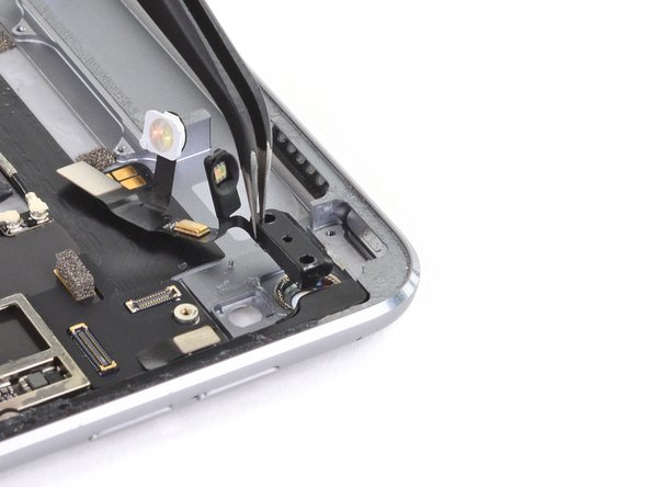

  59. iPad Pro 9.7" Power Button Assembly Replacement, Remove the power button bracket: passo 59, imagem 1 %32 iPad Pro 9.7" Power Button Assembly Replacement, Remove the power button bracket: passo 59, imagem 2 %32
    Ferramenta utilizada neste passo:
    • Use a pair of tweezers to remove the power button bracket.
