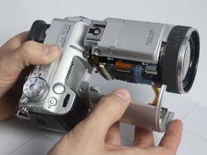

Remove the housing over the lens circuit board.
When removing the housing from over the circuit board, be cautious of static when touching the circuit board as to not fry any necessary components.
