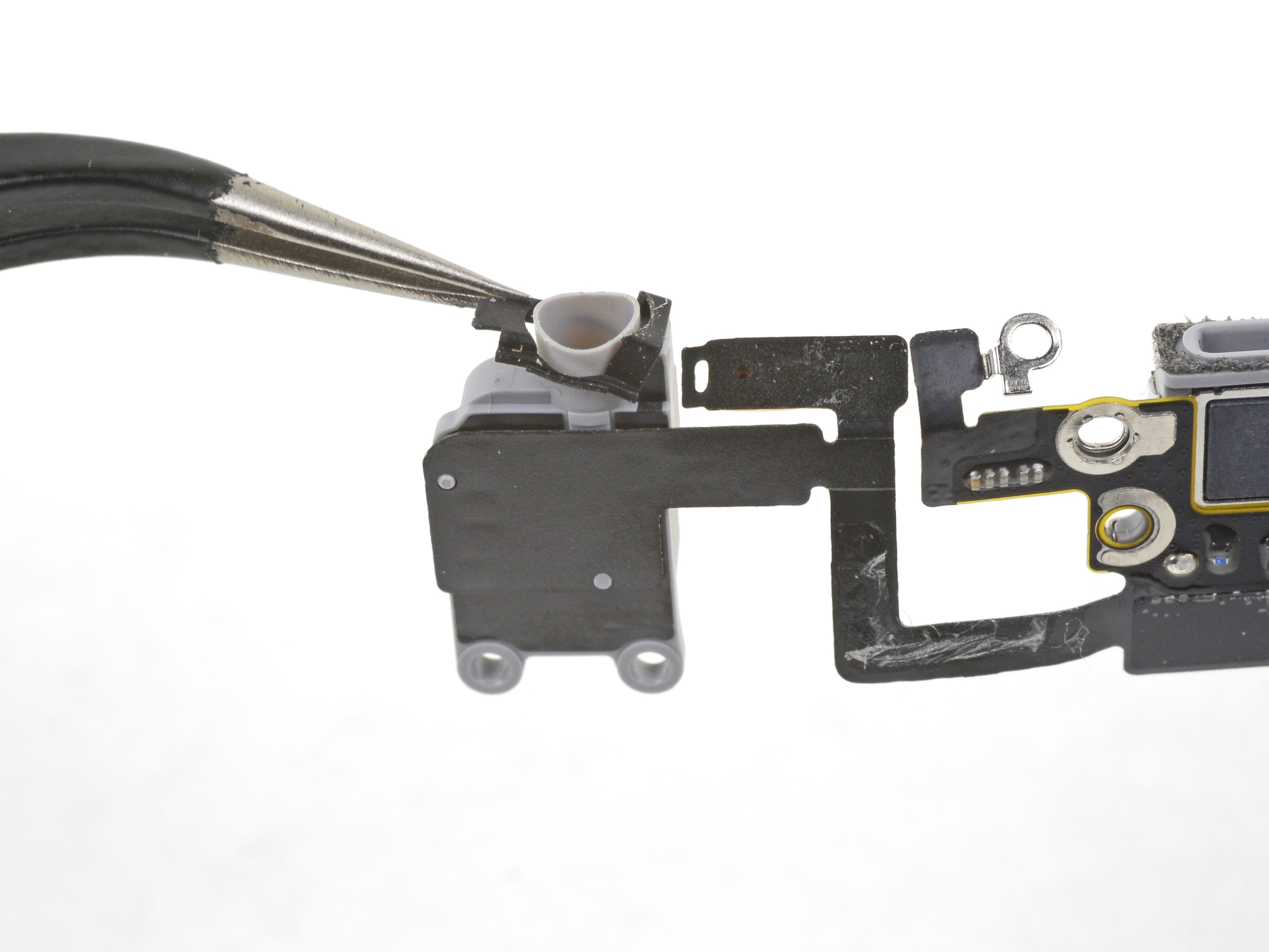

  36. iPhone 6s Plus Rear Case Replacement: passo 36, imagem 1 %32 iPhone 6s Plus Rear Case Replacement: passo 36, imagem 2 %32
    • Remove the audio control cable bracket.
    Pergunte ao FixBot
    Comentar
  37. iPhone 6s Plus Rear Case Replacement: passo 37, imagem 1 %32 iPhone 6s Plus Rear Case Replacement: passo 37, imagem 2 %32
    • Disconnect the audio control cable by prying its connector straight up from its socket on the logic board.

  69. iPhone 6s Plus Rear Case Replacement: passo 69, imagem 1 %32 iPhone 6s Plus Rear Case Replacement: passo 69, imagem 2 %32 iPhone 6s Plus Rear Case Replacement: passo 69, imagem 3 %32
    Ferramenta utilizada neste passo:
    • Remove the Lightning connector assembly.
    • If your replacement part did not come with a headphone jack gasket, use tweezers to remove the gasket from the old part and transfer it to the replacement part.
    • Before re-installation, use a spudger to scour any remaining adhesive residue from the rear case. You can use high concentration isopropyl alcohol to help with the process.
