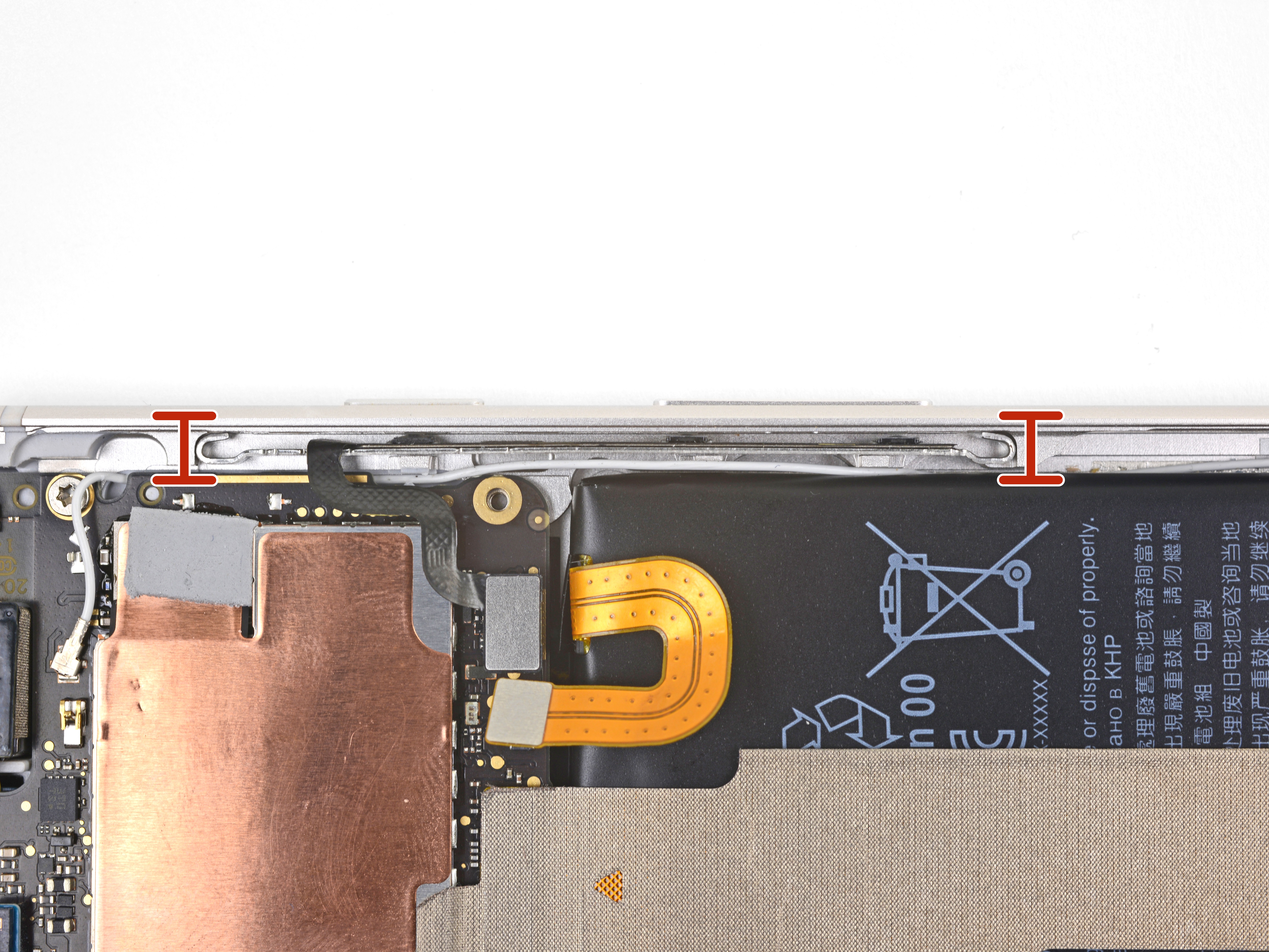

  18. Google Pixel XL Fingerprint Sensor Replacement, Motherboard: passo 18, imagem 1 %32 Google Pixel XL Fingerprint Sensor Replacement, Motherboard: passo 18, imagem 2 %32 Google Pixel XL Fingerprint Sensor Replacement, Motherboard: passo 18, imagem 3 %32
    • Use the point of a spudger to pry up and disconnect the battery connector.
    • Bend the battery flex cable slightly so that it will not accidentally touch the motherboard.

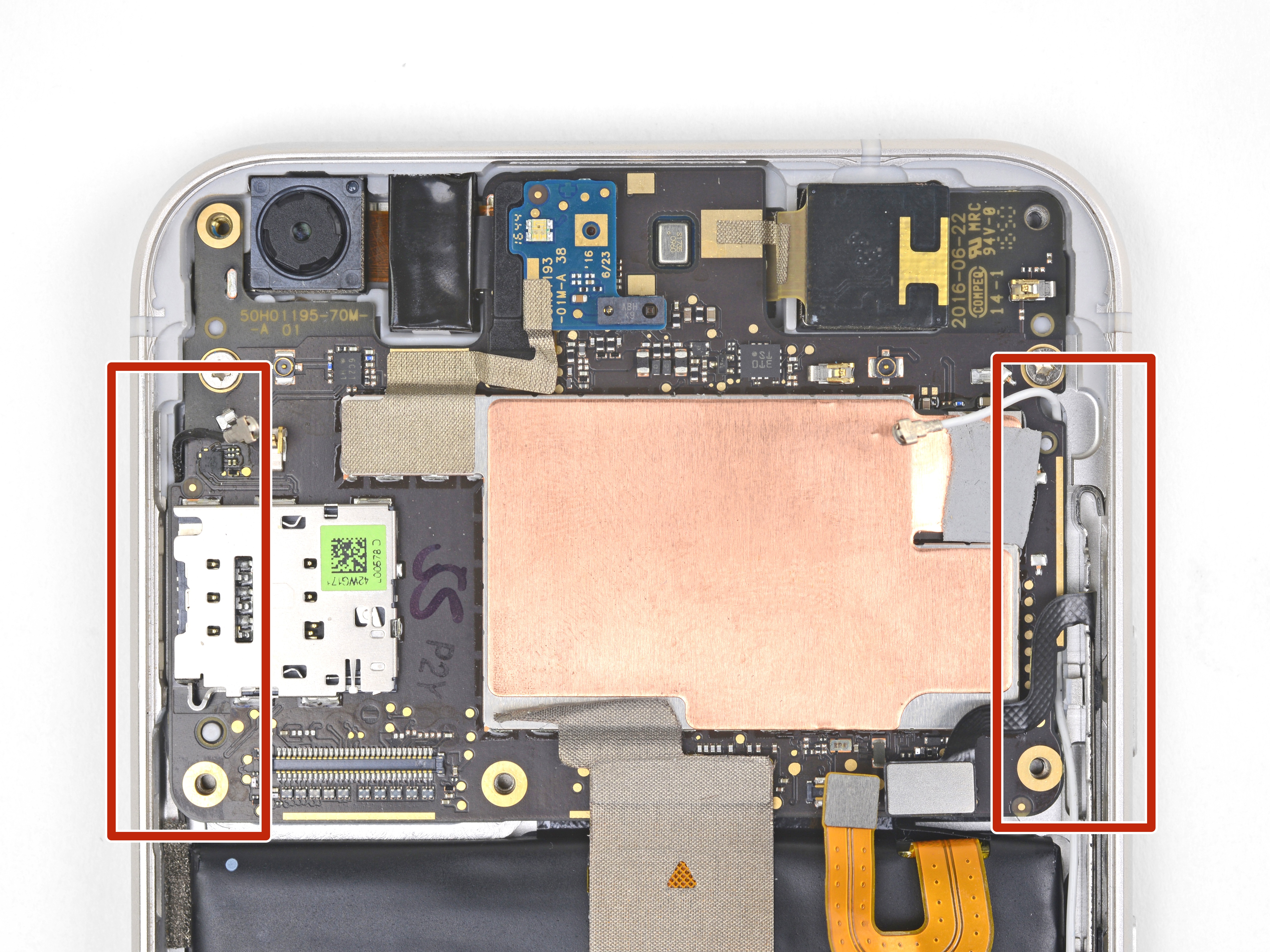

  24. Google Pixel XL Fingerprint Sensor Replacement: passo 24, imagem 1 %32
    • Remove the two 3 mm T5 screws securing the motherboard to the frame.
    • During reinstallation, be sure that both camera modules and the headphone jack module are seated properly in their sockets before screwing down the motherboard.

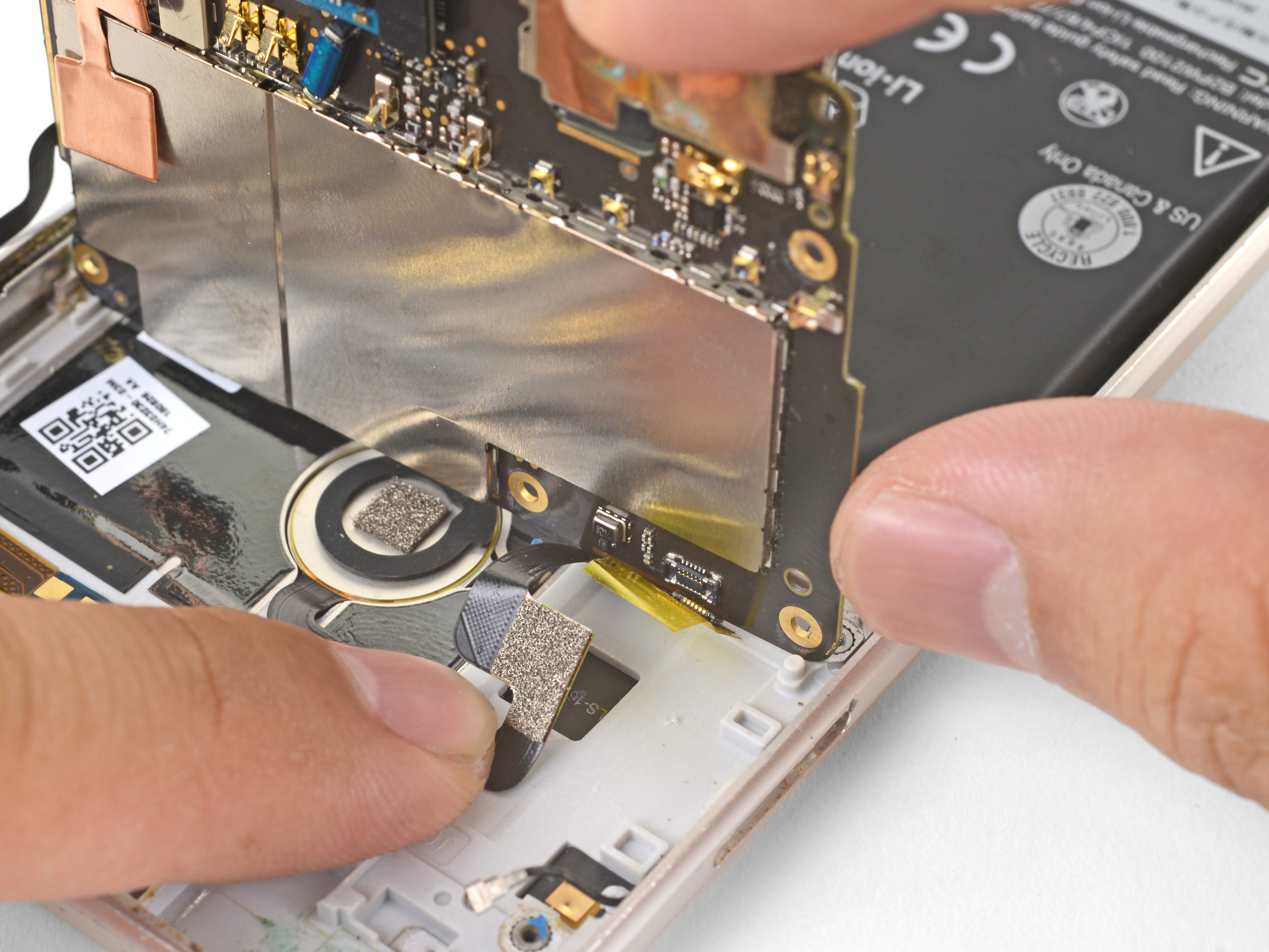

  27. Google Pixel XL Fingerprint Sensor Replacement: passo 27, imagem 1 %32 Google Pixel XL Fingerprint Sensor Replacement: passo 27, imagem 2 %32
    • Be sure that you have ejected the SIM card tray before performing this step.
    • Use the flat end of a spudger to pry the bottom edge of the motherboard up slightly, loosening it from its recess.
    • Do not try to remove the motherboard yet. It is still connected by a flex cable.

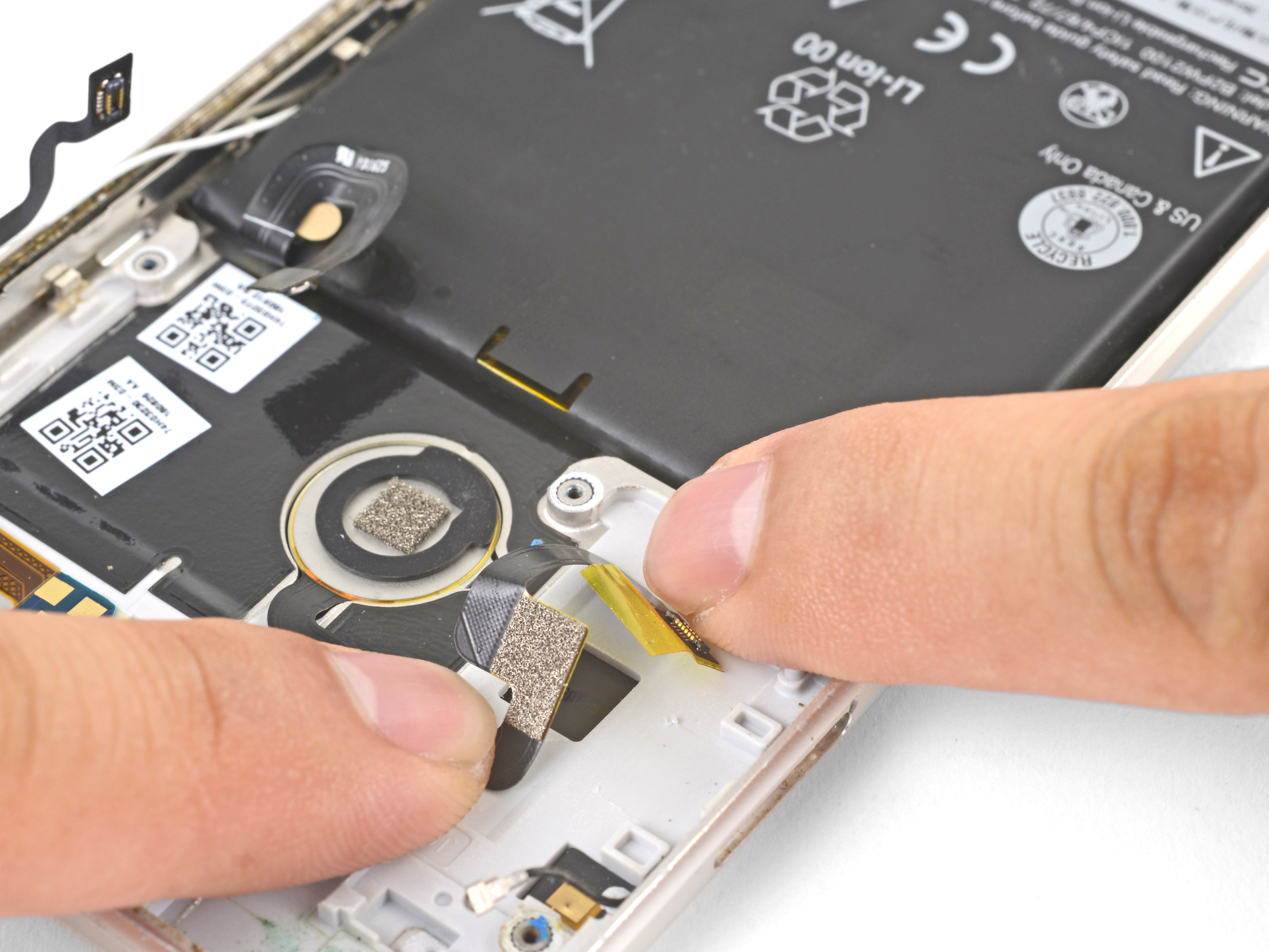

  28. Google Pixel XL Fingerprint Sensor Replacement: passo 28, imagem 1 %32 Google Pixel XL Fingerprint Sensor Replacement: passo 28, imagem 2 %32
    • Locate the fingerprint sensor cable attached to the underside of the motherboard, near the bottom edge.
    • Use the point of a spudger to pry and release the fingerprint sensor cable from its socket.
    • Peel the cable away from the motherboard.
    Pergunte ao FixBot

    • Align the fingerprint sensor's connector to the motherboard socket, which is located on the underside near the battery edge.
    • Use your finger to press the connector into the socket. Do not use excessive force! The connector should click into position if done correctly.

    • Move the motherboard into position near its recess.
    • Use your finger to press the fingerprint sensor down into its indentation.
    • Be sure that the sensor is properly aligned in the indentation.
    • Continue with the reassembly.
