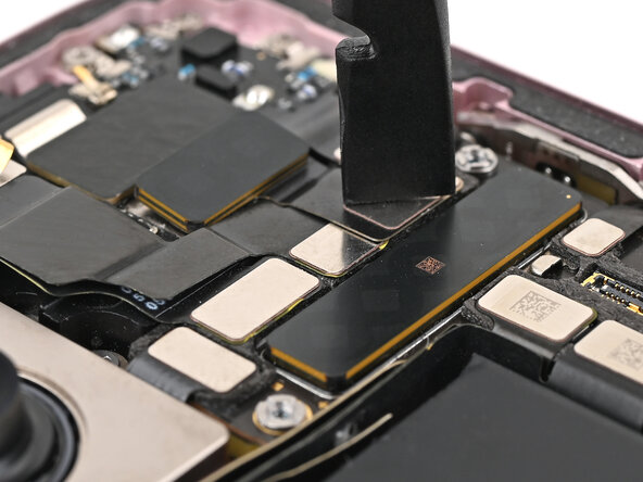

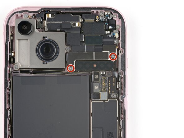

  25. iPhone 15 Front Camera Assembly Replacement, Remove the upper connector cover: passo 25, imagem 1 %32 iPhone 15 Front Camera Assembly Replacement, Remove the upper connector cover: passo 25, imagem 2 %32 iPhone 15 Front Camera Assembly Replacement, Remove the upper connector cover: passo 25, imagem 3 %32
    • Use your tri-point Y000 driver to remove the two 1.3 mm‑long screws securing the upper connector cover.
    • Remove the cover.

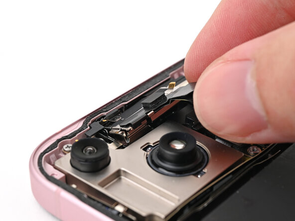

  26. iPhone 15 Front Camera Assembly Replacement, Disconnect the front camera and sensors: passo 26, imagem 1 %32 iPhone 15 Front Camera Assembly Replacement, Disconnect the front camera and sensors: passo 26, imagem 2 %32 iPhone 15 Front Camera Assembly Replacement, Disconnect the front camera and sensors: passo 26, imagem 3 %32
    • Use the tip of an opening pick to pry up and disconnect the antenna, front sensors, and front camera press connectors (three connectors in total).

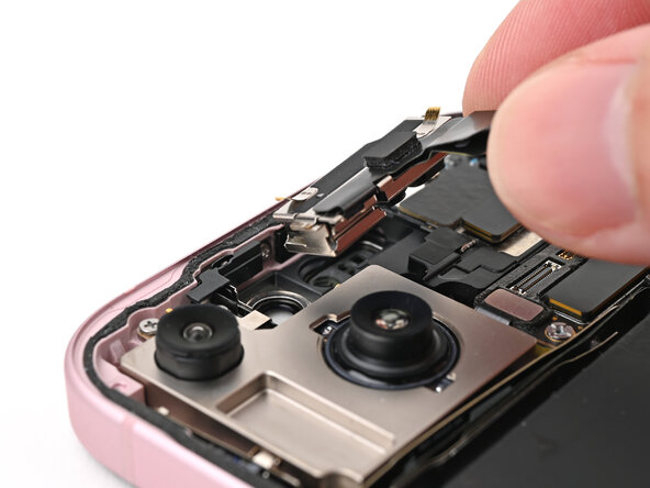

  27. iPhone 15 Front Camera Assembly Replacement, Remove the front camera and sensors: passo 27, imagem 1 %32 iPhone 15 Front Camera Assembly Replacement, Remove the front camera and sensors: passo 27, imagem 2 %32
    Ferramenta utilizada neste passo:
    • Use tweezers or your fingers to pull the front camera and sensors out of their recess in the frame and remove them.

  44. iPhone 15 Front Camera Assembly Replacement, Install the cover screws: passo 44, imagem 1 %32 iPhone 15 Front Camera Assembly Replacement, Install the cover screws: passo 44, imagem 2 %32
    • Use a tri-point Y000 screwdriver to install the 0.9 mm‑long screw securing the middle connector cover.
    • Use a tri-point Y000 screwdriver to install the two 1.3 mm‑long screws securing the lower connector cover.
