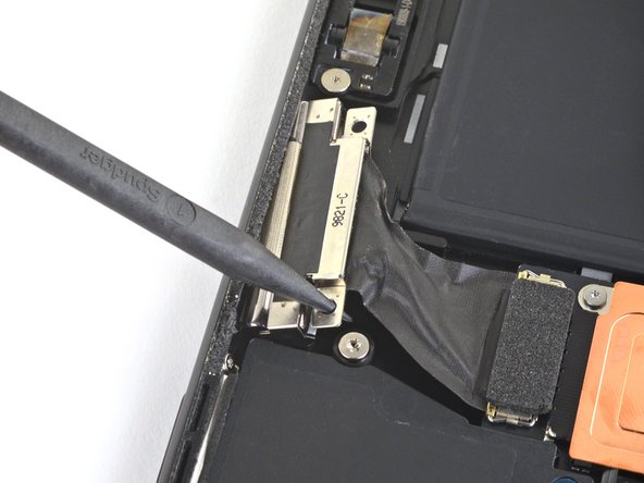

  26. Microsoft Surface Pro X Surface Connect Port Replacement, Dislodge the Surface Connect port: passo 26, imagem 1 %32 Microsoft Surface Pro X Surface Connect Port Replacement, Dislodge the Surface Connect port: passo 26, imagem 2 %32
    • The Surface Connect port connector can be disconnected before moving the port, but the connector is difficult to reconnect while the port is fully seated. During reassembly, it is easier to reconnect the connector before seating the port into its recess.
    • Use the flat end of a spudger to pry up the left screw tab and dislodge the Surface Connect port from the frame.
    • You only need to lift the port high enough to insert the pointed end of a spudger into the screw tab.

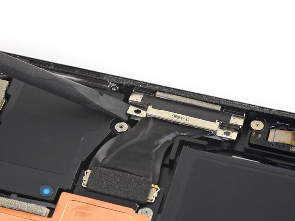

  27. Microsoft Surface Pro X Surface Connect Port Replacement, Detach the Surface Connect port: passo 27, imagem 1 %32 Microsoft Surface Pro X Surface Connect Port Replacement, Detach the Surface Connect port: passo 27, imagem 2 %32
    • Insert the pointed end of a spudger into the left screw tab.
    • Push the Surface Connect port toward its connector to detach its magnets from the frame.
    • You only need to push the port enough to detach it from the frame and grab it with your fingers. Don't bend the cable more than necessary.

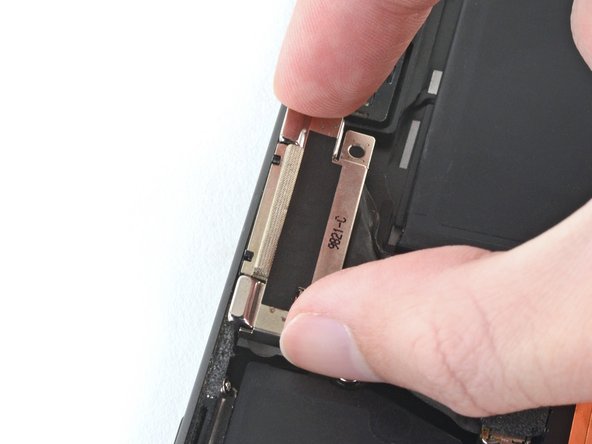

  28. Microsoft Surface Pro X Surface Connect Port Replacement, Move the Surface Connect port: passo 28, imagem 1 %32 Microsoft Surface Pro X Surface Connect Port Replacement, Move the Surface Connect port: passo 28, imagem 2 %32
    • Hold the edges of the Surface Connect port with your fingers.
    • Pull the port away from the edge of the frame and place it on top of the edge.

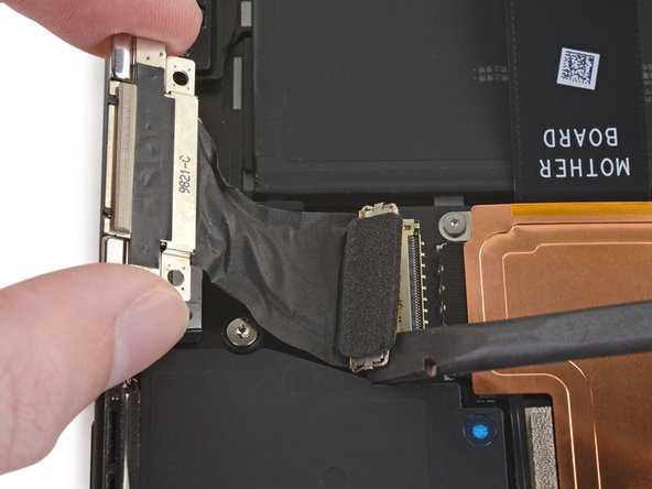

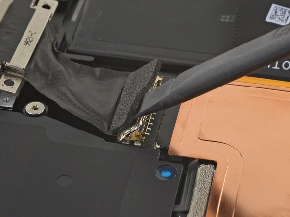

  29. Microsoft Surface Pro X Surface Connect Port Replacement, Disconnect the Surface Connect port: passo 29, imagem 1 %32 Microsoft Surface Pro X Surface Connect Port Replacement, Disconnect the Surface Connect port: passo 29, imagem 2 %32
    • Insert the flat end of a spudger under the foam on top of the Surface Connect port's connector.
    • Lift up on the foam to open the connector's locking tab.

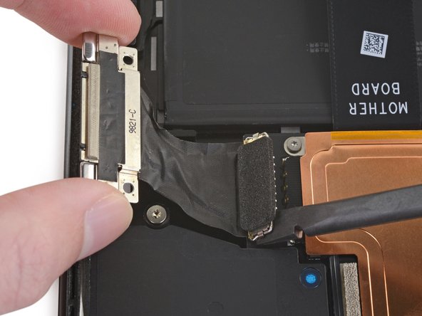

  30. Microsoft Surface Pro X Surface Connect Port Replacement: passo 30, imagem 1 %32 Microsoft Surface Pro X Surface Connect Port Replacement: passo 30, imagem 2 %32 Microsoft Surface Pro X Surface Connect Port Replacement: passo 30, imagem 3 %32
    • Place the flat end of a spudger under the left edge of the connector's locking tab.
    • While holding the Surface Connect port with your fingers, push the connector out of its socket in the direction of the cable.
    • If this doesn't fully disconnect the connector, repeat this step for the right edge of the locking tab. Alternate between the left and right edge as needed.
