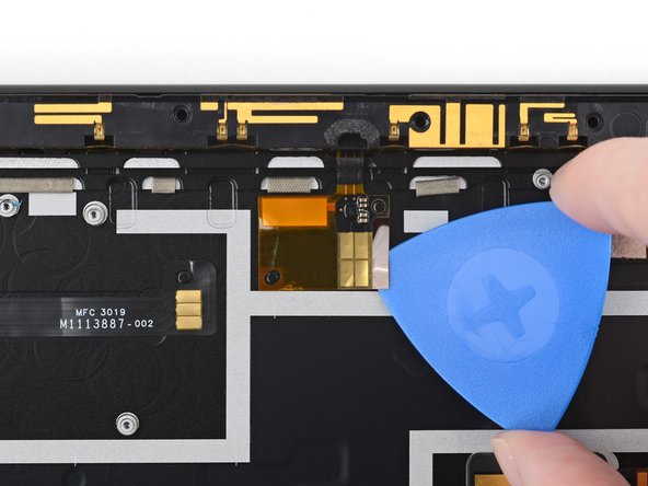

  15. Microsoft Surface Pro X Sensor Bar Replacement, Open the Surface: passo 15, imagem 1 %32 Microsoft Surface Pro X Sensor Bar Replacement, Open the Surface: passo 15, imagem 2 %32 Microsoft Surface Pro X Sensor Bar Replacement, Open the Surface: passo 15, imagem 3 %32
    • Do not remove the screen yet. It is still connected to the motherboard by the display cable. Keep the screen as close as possible to the Surface's frame to avoid straining the display cable.
    • Avoid hitting the battery with the screen during this procedure. A punctured or bent battery may leak dangerous chemicals or cause a thermal event.
    • Lift up the top edge of the screen so that it is at a 30° angle with the frame.
    • If you encounter any resistance, stop and check that all the adhesive is separated. Use an opening pick to cut through any remaining adhesive.
    • Rotate the screen so that its bottom edge is in the middle of the frame. The screen should be perpendicular to the frame.
    • Rotate the screen 90° so that it is facing down. Place the screen on the frame.

  107. Microsoft Surface Pro X Sensor Bar Replacement, Detach the sensor bar connector from the frame: passo 107, imagem 1 %32 Microsoft Surface Pro X Sensor Bar Replacement, Detach the sensor bar connector from the frame: passo 107, imagem 2 %32
    • The sensor bar's connector is lightly adhered to the frame.
    • Use an opening pick to cut through the adhesive under the left edge of the sensor bar connector.
  108. Microsoft Surface Pro X Sensor Bar Replacement: passo 108, imagem 1 %32 Microsoft Surface Pro X Sensor Bar Replacement: passo 108, imagem 2 %32
    • Repeat the previous step for the right edge of the connector.
  109. Microsoft Surface Pro X Sensor Bar Replacement: passo 109, imagem 1 %32 Microsoft Surface Pro X Sensor Bar Replacement: passo 109, imagem 2 %32
    • Slide the opening pick under the center of the connector to detach it from the frame.

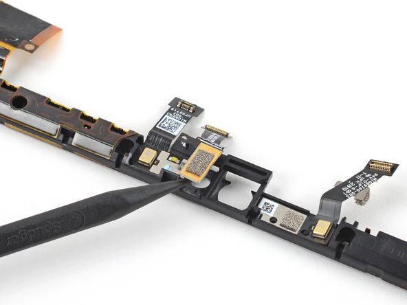

  111. Microsoft Surface Pro X Sensor Bar Replacement, Windows Hello face camera information: passo 111, imagem 1 %32 Microsoft Surface Pro X Sensor Bar Replacement, Windows Hello face camera information: passo 111, imagem 2 %32 Microsoft Surface Pro X Sensor Bar Replacement, Windows Hello face camera information: passo 111, imagem 3 %32
    • You may need to transfer your original Windows Hello face camera from the old sensor bar to the replacement sensor bar.
    • Use the pointed end of a spudger to lift and detach the Windows Hello face camera from the sensor bar.
    • Remove the Windows Hello face camera.
