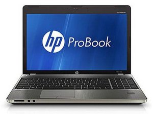

How to fix boot error problem

A boot error on an HP ProBook 4530s usually comes from incorrect BIOS settings, a failing drive, or corrupted boot files. First, enter BIOS (press F10 on startup) and ensure the hard drive is detected and set as the first boot device. If detected, run HP Diagnostics (F2) to check HDD health. If the drive fails tests, replace it. If the drive passes, boot from a Windows installation USB, choose Repair your PC, then run Startup Repair. You can also use Command Prompt to run bootrec /fixmbr, /fixboot, and /rebuildbcd. Update BIOS if needed. If errors persist, reinstall Windows.
