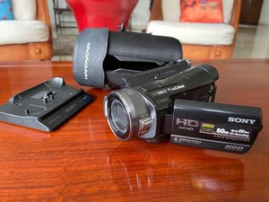

Sony HDR-SR7 LCD replacement
I learnt from ifixit how to - and was able to successfully - remove the LCD screen from my HDR-SR7. However, I have been unable to find a replacement LCD panel in any aftermarket (eBay, Ali Express, etc.).
I was able to find LCD screens for Sony HDR-HC1E HVR-A1C HC1E A1C DCR- HC42E HC43E HC46E HC48E HC90E HC96E on Ali Express. Those screens are the same size (2.7”) as HDR-SR7, but of a different resolution: HDR-SR7 LCD is 211K pixels, while the others are 123.2K pixels. The position of the cables are the same.
Question: what will happen if i replace the sony hdr-sr7 lcd screen with sony DCR-HC96E lcd screen?
Will the LCD screen display any picture at all?
Will the picture be the same, but only of a lower resolution?
Will the picture be cropped in or cropped out?

Do you happen to have a guide for how to disassemble it to take the screen out? I need to do this and I cannot find any guide. Also, did you find any screen replacement?
por
There are a few video tutorials on YouTube and photo tutorials on ifixit for various Sony camcorder models. I did not find the one specific to my model but studying the ones for the listed models closely I was able disassemble and remove the screen fairly easily. You just need to be patient and careful.
I found an LCD screen with lower pixels than mine and wasn’t sure how that would work, so I had posted the question above. It was selling cheap on Ali Express so I went ahead and purchased it before I got a response. I needed 211Kp and the one I got was 123.2Kp. What it did was stretch the image horizontally and displayed on the LCD about half (or 123.2/211 fraction to be exact) the image on the Viewfinder.
I am still looking for the 211Kp LCD with no luck on Ali Express. It seems that a search with the part number does not yield results…

Hi @tirthasarkar
Not sure if they will work as all the models you mentioned are used with NTSC system whereas the SR7 is PAL system i.e. 525 lines vs 625 lines so perhaps the screen connections may not be the same and it won't work or it won't interpret and display the video signals the same.
Is there a Sony part number on the back of the LCD screen? If there is and if you haven't already done so, try searching for that.
