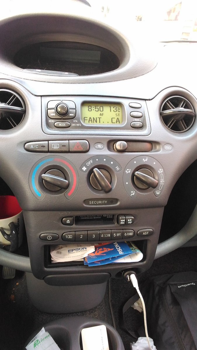

Hello everyone
I have a Toyota Yaris 2002 with a factory radio model 86110-52021-BO (Manufactured by Matszushita) and I am trying to connect an adaptor to be able to connect my smartphone via AUX. The problem that the adaptor I bought does not fit the plug in my radio, and I am unable to discover what is the official technical name of this plug, since I cannot even find the manual of this radio inline..
I know it is a difficult question, but maybe some of the experts here have experience with these kind of old systems..
Here are some pics of the system:
Imagem
Imagem
Imagem
Imagem
Thanks for the help :)

Hi @lior_k1 ,
Have you got access to the radio?
Can you take pictures of the connector in the radio (both inside the radio case and outside if possible) and post back here
Here's how to do it Adicionar imagens a uma pergunta já existente
Perhaps someone can identify the connector for you.

HI @lior_k1
Does the radio have the option to select an aux input at all?
If not how are you going to make the radio switch away from the AM/FM radio to the aux input?
Found this link for a 2008 Yaris which shows the wiring connections and there are no terminals designated "aux input".
It may be easier to invest in a car FM transmitter

Hi Jay,
In fact there is no option of aux in the system, only a tape and radio options. I saw that they sell online a convertor to connect directly to the radio to make an aux and USB plugs, but it does not fit the plug I have (see the pics).
FM radio transmitter has too much interference for my opinion, at this point I think I will just get a new radio.. thought I could solve it with an adapter but looks like it's not going to work..

You could buy a PC2- 17-4 adapter and install an aftermarket radio. Then you could have Radio, Aux and Bluetooth connectivity with the right 3rd party system. Most third party radios come in a standard size and shape that fit nicely into that small blank cubby hole below the CD/Tape player in the Yaris dash (and most other Toyota models of this era).
This is the adapter that converts from the Toyota/Japenese standard plugs to the more uiversal/Europe standard: https://www.amazon.co.uk/Autoleads-PC2-1...
This is then "Amazon's Choce" aftermarket radio, though I'm sure you could Ebay one for half the price if you're on a budget.: https://www.amazon.co.uk/Kidcia-Single-D...
Here's a good guide I found: https://www.google.co.uk/url?sa=i&rct=j&...
