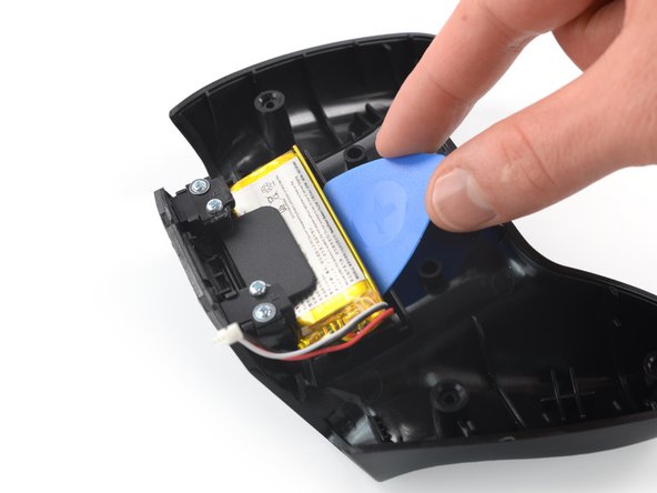

  11. SteelSeries Nimbus+ Controller Battery  Replacement, Pry up the battery: passo 11, imagem 1 %32 SteelSeries Nimbus+ Controller Battery  Replacement, Pry up the battery: passo 11, imagem 2 %32
    • The battery is held in place by mild adhesive.
    • Insert the edge of an opening pick into the gap between the battery and the back cover assembly.
    • Take care not to puncture or bend the battery with your tool—a punctured or bent battery may leak dangerous chemicals or cause a fire.
    • Use the opening pick to carefully pry up the battery and loosen the adhesive.
    Pergunte ao FixBot
    Comentar
  12. SteelSeries Nimbus+ Controller Battery  Replacement, Remove the battery: passo 12, imagem 1 %32
    • Remove the battery.
    • Do not reinstall a damaged or deformed battery, as doing so is a potential safety hazard.
    • Make sure to align the battery and the back cover of the controller correctly during reassembly.
