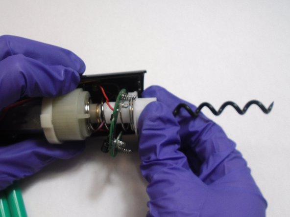

    1. Modal MD-WORCSS6 Motor Replacement, Motor: passo 6, imagem 1 %32 Modal MD-WORCSS6 Motor Replacement, Motor: passo 6, imagem 2 %32 Modal MD-WORCSS6 Motor Replacement, Motor: passo 6, imagem 3 %32
      • Slide the circuit board out of its slot.
      • Pull the white plastic neck down and out of the slot. Remove the neck and body spring.
      Pergunte ao FixBot
      Comentar
    2. Modal MD-WORCSS6 Motor Replacement: passo 7, imagem 1 %32
      • Use wire cutters to cut the wires connected to the bottom of the motor.
      • Remove the motor from the plastic body.
      Pergunte ao FixBot
      Comentar
    3. Modal MD-WORCSS6 Motor Replacement: passo 8, imagem 1 %32
      • Strip the insulation from the wire up to about half an inch from the end of the exposed wire.
      • Attach a new motor to the device by re-soldering the connections that were cut earlier.
      • Check out our How to Solder and Desolder Connections guide for best practices and soldering tips.
