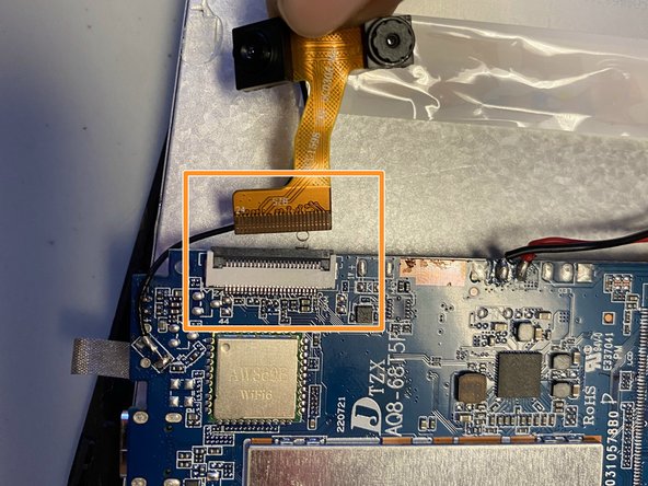

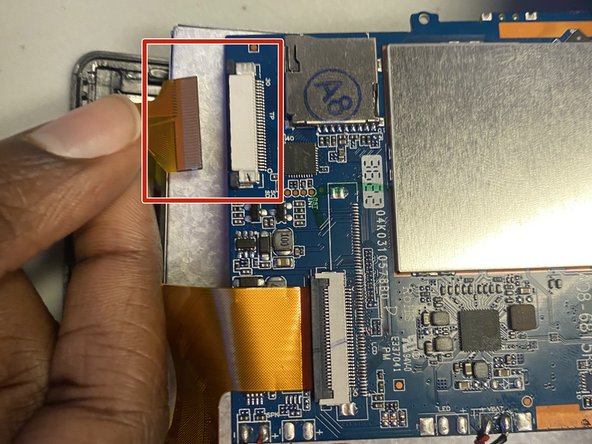

    • Locate the three golden ribbons along the perimeter of the motherboard.
    • There are two dark tabs; pull each away from the cream connection port. Once tabs are in open position remove the gold ribbon.
    • Flip up the dark tab and pull the gold ribbon away.
    • Do not pull the the cables harshly as it could rip the ribbon.
    • Reference this guide for more help with attaching or detaching cables.

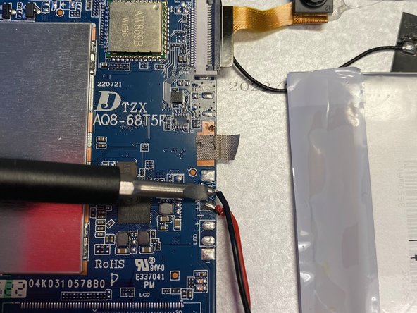

    • Detach the motherboard from the battery by pressing the soldering tip tool to each of the three connection points.
    • Exercise caution when desoldering the battery.
    • The tool located in the pictures is not the soldering tip tool but rather used for reference of where to detach.
    • Reference this guide for more help with soldering and desoldering the connections.
