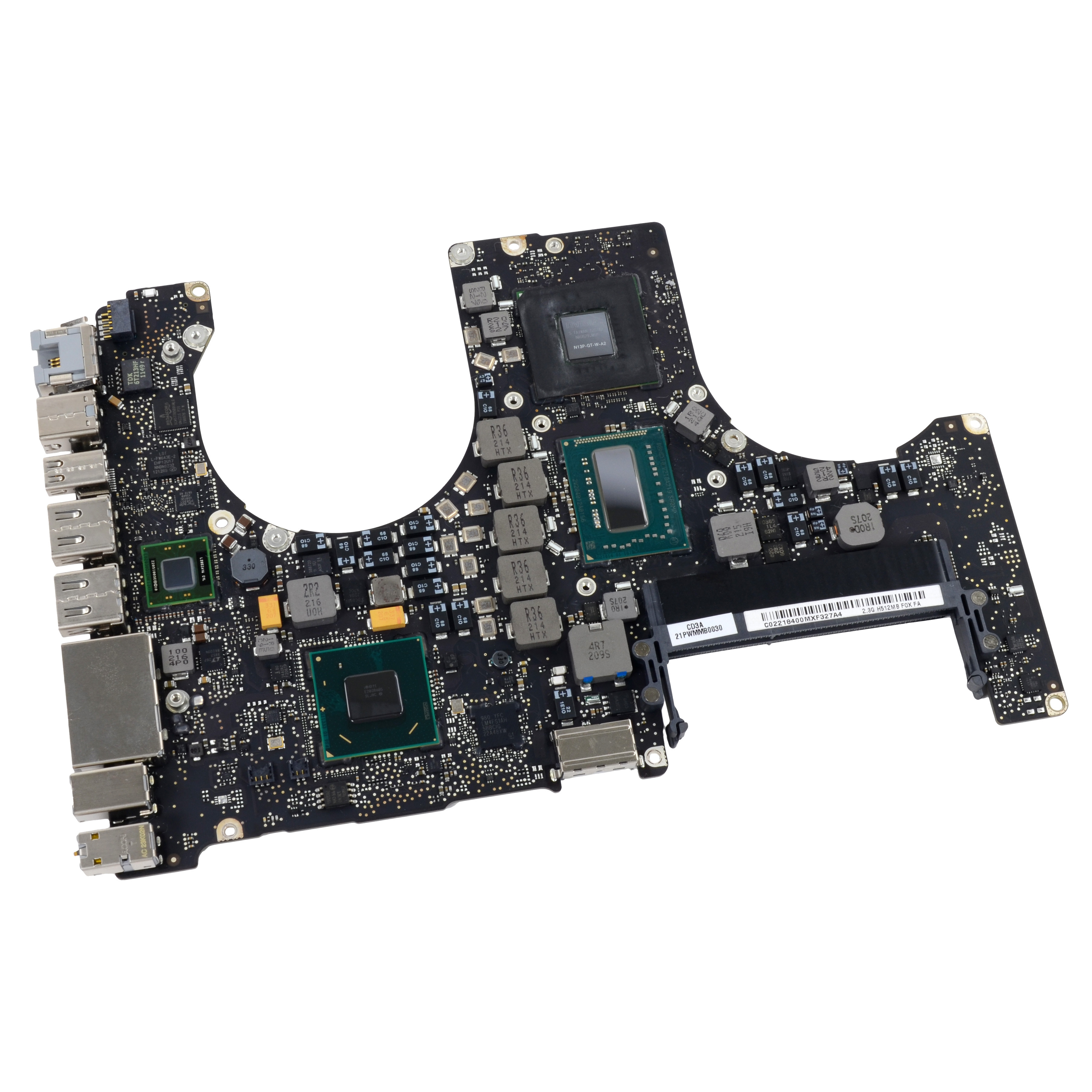

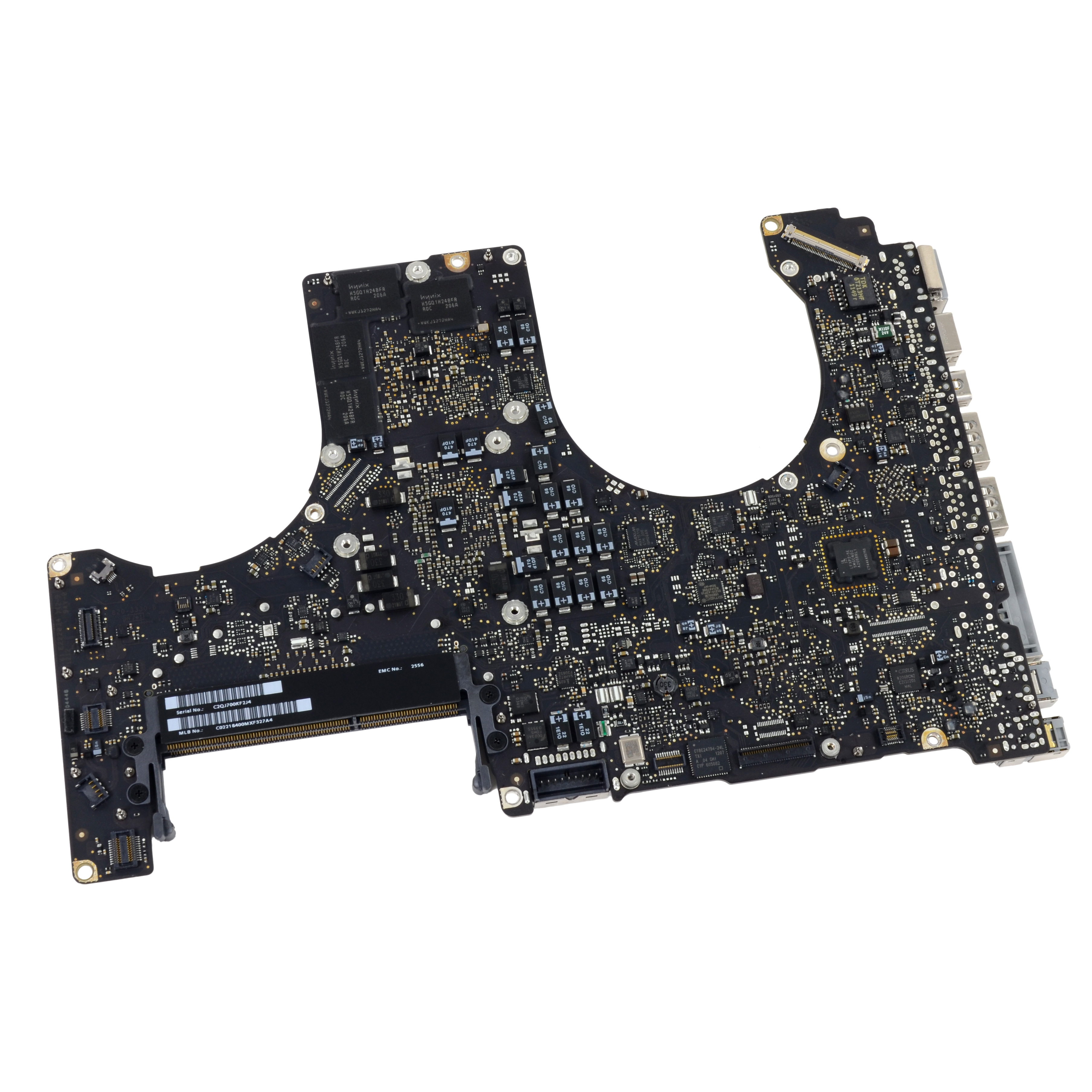

Sounds like you have something burning inside. Have you opened the system yet? I would start there looking for plastic parts that appear melted. Also look at the components not just on the visible side you’ll really need to take the logic board out. You might as well clean the old thermal paste off and apply a fresh coat.
Follow this guide MacBook Pro 15" Unibody Mid 2012 Logic Board Replacement

thank you so much for getting back! I had the Genius Bar take a look at it a while back (I hadn’t used it too much until it became our only computer) and they supposedly cleaned it out saying it was very clean actually, but when that didn’t fix the issue I kind of got fed up and debated on just getting a new computer altogether since they were going to charge quite a bit to take a deeper look. So, you think replacing the logic board with new thermal paste should do the trick? It’s not so much of a burning smell.. just some type of cheap degraded plastic from being sunburnt (sounds weird, but that’s exactly how it smells lol)… any recommendations on whether to replace the keyboard or maybe the fan or something toward the back of the computer toward the screen which could be made of a cheaper plastic ? thanks again!
por
I think you jumped 20 steps here. Lets focus on looking and smelling ;-}
As you are taking the logic board out (not replacing it) to inspect we might as well clean the thermal paste off the CPU and heat sink. Are you up to this? Review the guide fully and then again! You'll use the guide in the reverse order to put things back.
Focus on melted plastic or staining. Compare the pictures here MacBook Pro 15" Unibody (Mid 2012) 2.3 GHz Logic Board to your system do you see something different?
Bottom
Top
por
