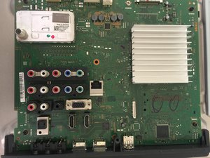

I have a Sony kdl 52ex701 the audio is ok but no video. Changes channels and everything ok except the video.
Thanks for taking interest in helping solve my issue.
I've tried all kinds of stuff. Like all the inputs local tv antena they all have the same result audio works fine but no video. The picture is not completely black it's kind of dark almos black purple.
When I switch inputs it changes to black as it suppose to and then back to purple and audio works but no video.
I opened the tv vacuumed all the boards and tv itself. I didn't noticed any bad components on the boards or tv itself.
I get normal green light when on and red when off. No codes or anything in particular.

Checked fuse f101 ok. I purchased a refurbished and solved the problem even though it has an intermittent issue that when it’s turned on for the first time it has a blurry screen for a minute or two. Then it works ok. I hear a humming capacitor till it stops and then it stops.

@estesi you are not telling us what you have checked. It is important that you check all inputs. Make sure that you connect inputs to HDMI Coax Composite etc. Verify that you have no video on all of those. You also need to check your standby LED and tell us if there are any flashing code on that one. If so, let us know what it shows.
In a darkened room turn the TV on and set it to a station where yo know you should get a picture. Then use a flashlight and shine it at an angle against the screen. See if you can make out any shadows/shapes. Right now it does sound like your backlight is not functioning, which could be an issue with your power board/LED driver or the LED array as well as your T-con board. Unplug your TV and remove the back. Take some good pictures of the layout of the boards as well as the individual boards and post those with your question. That will allow us to see what you see. Use this guide Adicionar imagens a uma pergunta já existente for that. You will need a multimeter for further testing, so make sure that you have access to one of those.
Update (01/14/2018)
check the marked fuse for continuity first. After that check to see what voltage it gets when you turn your TV on.

"changes to black as it suppose to and then back to purple" sounds like you are getting a backlight but not a picture. That could be your main board or your T-con board. Post the images you posted on the external link with your question as well. You also need to remove the shield from the board in your first image.
por
i checked the fuse and voltage is 12.62v Is that correct
por
Yes it is. Glad you got it fixed!
