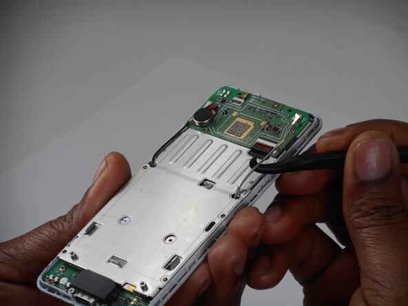

  8. Punkt MP02 Keyboard Membrane Replacement: passo 8, imagem 1 %32 Punkt MP02 Keyboard Membrane Replacement: passo 8, imagem 2 %32 Punkt MP02 Keyboard Membrane Replacement: passo 8, imagem 3 %32
    • Remove the antenna coaxial connectors on the board with a spudger by gently prying straight up where they are connected on the board.
    Pergunte ao FixBot

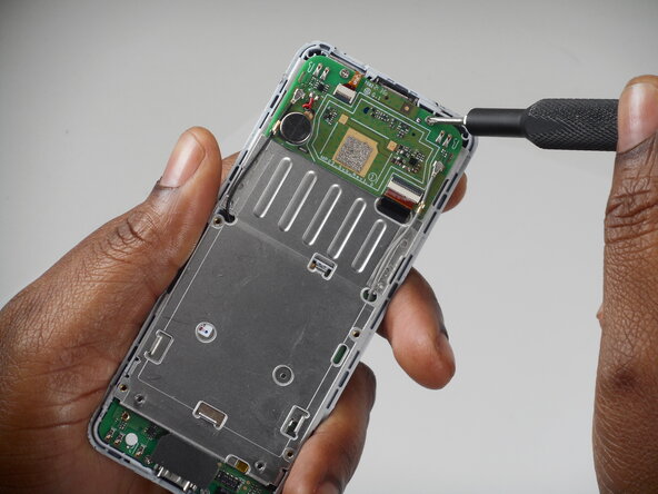

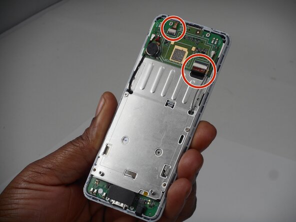

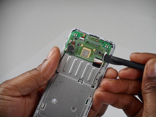

  9. Punkt MP02 Keyboard Membrane Replacement: passo 9, imagem 1 %32 Punkt MP02 Keyboard Membrane Replacement: passo 9, imagem 2 %32 Punkt MP02 Keyboard Membrane Replacement: passo 9, imagem 3 %32
    • Flip up the two black locking flaps securing each of the two ribbon cables.
    • Disconnect the two ribbon cables.
    Pergunte ao FixBot
    Comentar

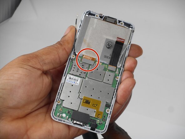

  11. Punkt MP02 Keyboard Membrane Replacement: passo 11, imagem 1 %32 Punkt MP02 Keyboard Membrane Replacement: passo 11, imagem 2 %32 Punkt MP02 Keyboard Membrane Replacement: passo 11, imagem 3 %32
    • Use a spudger to lift and disconnect the screen press connector.
    • Make sure to pry up on the edge of the connector, not the board itself.
    • Remove the screen.

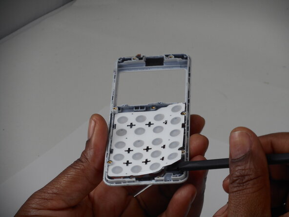

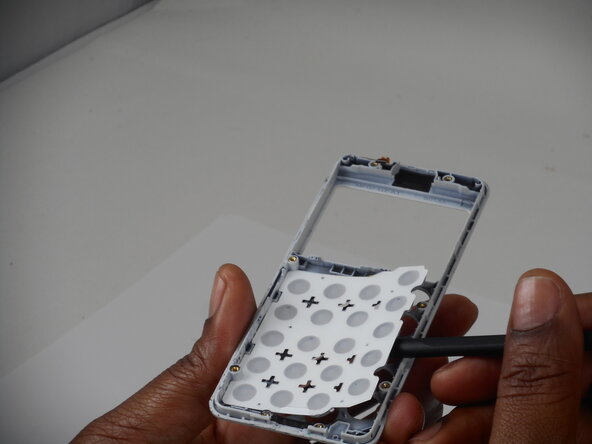

  14. Punkt MP02 Keyboard Membrane Replacement: passo 14, imagem 1 %32 Punkt MP02 Keyboard Membrane Replacement: passo 14, imagem 2 %32 Punkt MP02 Keyboard Membrane Replacement: passo 14, imagem 3 %32
    • Peel the keyboard membrane off the phone casing.
    Pergunte ao FixBot
