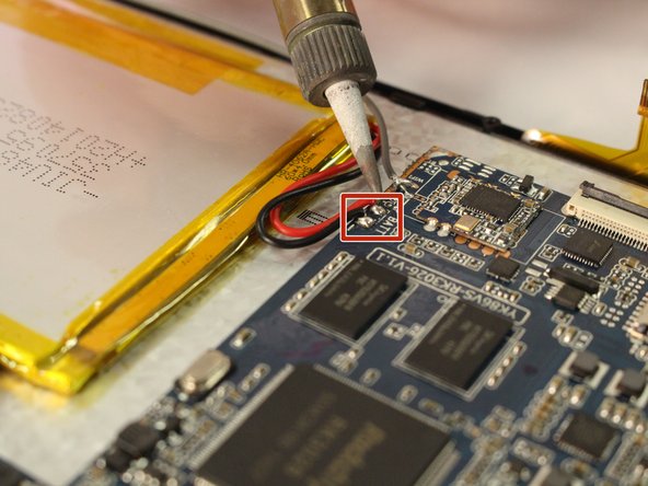

    1. ProScan PLT7050 Battery Replacement, Battery: passo 3, imagem 1 %32 ProScan PLT7050 Battery Replacement, Battery: passo 3, imagem 2 %32
      • Use the soldering tool to remove the wires from the motherboard. (Black and Red)
      • The soldering tool is hot.
      • Take note of where the wires are located.

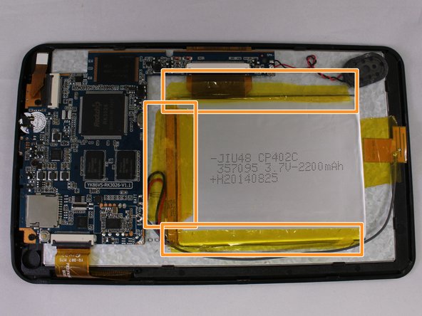

    2. ProScan PLT7050 Battery Replacement: passo 4, imagem 1 %32 ProScan PLT7050 Battery Replacement: passo 4, imagem 2 %32
      • Remove the black tape from the battery.
      • Remove the three pieces of yellow tape from the battery.

    3. ProScan PLT7050 Battery Replacement: passo 5, imagem 1 %32
      • Use the plastic opening tool to pry the battery from the device as it is attached by an adhesive.
      • Do not proceed if corrosion and/or swelling of the battery is visible.
