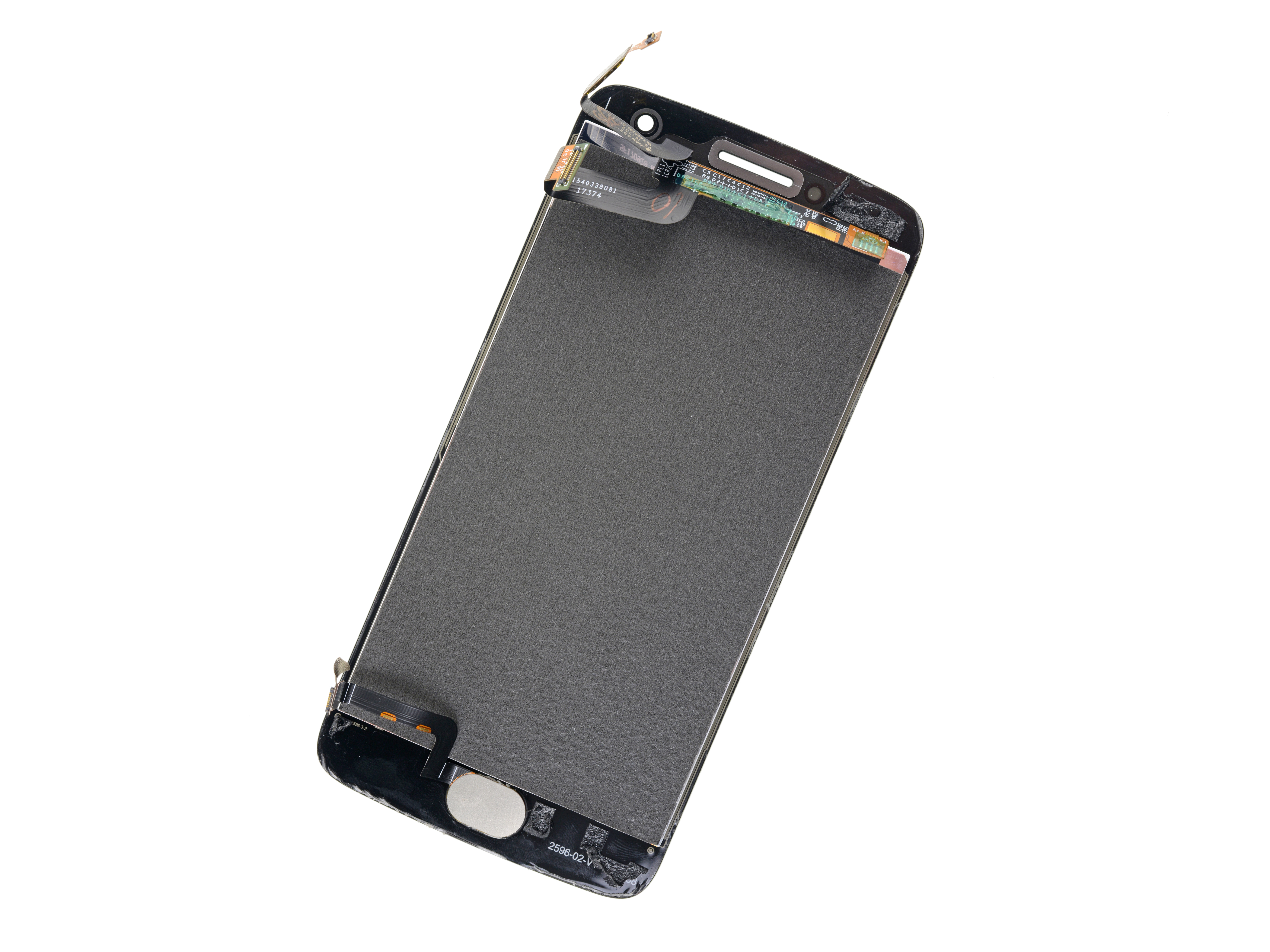

  16. Motorola Moto G5 Plus Display Assembly Replacement: passo 16, imagem 1 %32 Motorola Moto G5 Plus Display Assembly Replacement: passo 16, imagem 2 %32
    • Remove the display assembly from the phone.
    • Before you reinstall the display assembly, thoroughly remove any remaining adhesive and glass from the frame of the device with isopropyl alcohol.
    • Be sure to turn on your phone and test your repair before installing new adhesive and sealing the display assembly.
    • If your replacement display doesn't have touch functionality and you're sure that it has been installed correctly, back up your data and perform a factory reset.
