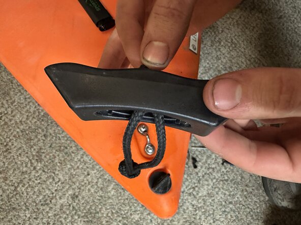

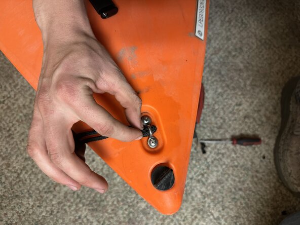

    2. Kayak Handle Replacement: passo 2, imagem 1 %32 Kayak Handle Replacement: passo 2, imagem 2 %32 Kayak Handle Replacement: passo 2, imagem 3 %32
      • Insert the screwdriver into the head of the bolt on the bottom side of the handle.
      • Apply pressure to the bottom of the handle.
      • Remove the top part of the handle by using the screwdriver to pop it out.
      • Caution: Do not let the hardware fall into the hull, as it may slide into unreachable areas of the bow or stern.

    3. Kayak Handle Replacement: passo 3, imagem 1 %32 Kayak Handle Replacement: passo 3, imagem 2 %32
      • Pull the paracord out of the handle so they are separate from each other.

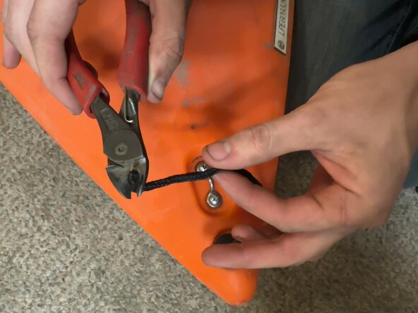

    4. Kayak Handle Replacement: passo 4, imagem 1 %32 Kayak Handle Replacement: passo 4, imagem 2 %32 Kayak Handle Replacement: passo 4, imagem 3 %32
      • Cut the end of the paracord using your knife or a pair of scissors.
      • Insert the paracord into the bottom side of the handle through the small hole.
      • Pull it through so each side of the paracord is evenly inserted.
