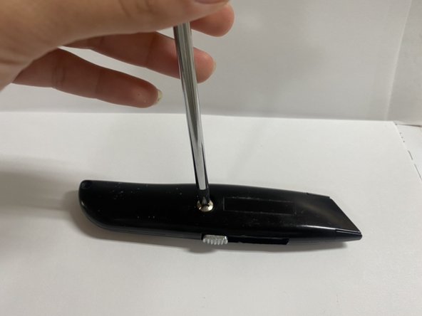

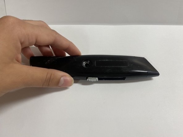

    • Using a Phillips head screwdriver, unscrew the screw on the box cutter.
    • Remove the top part of the box cutter.

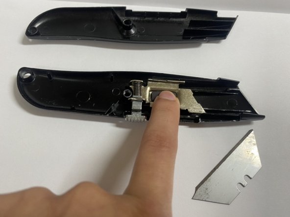

    • Caution: Sharp Object Involved
    • Pick up the blade.
    • Separate the blade from the trigger.

    • Look for the sliding bar and circle which will be located towards the end of the box cutter.
    • Place the trigger aligning with the sliding bar and the circle in the middle of the box cutter.
    • Apply pressure with your finger onto the magnetic part of the trigger to secure placement.
