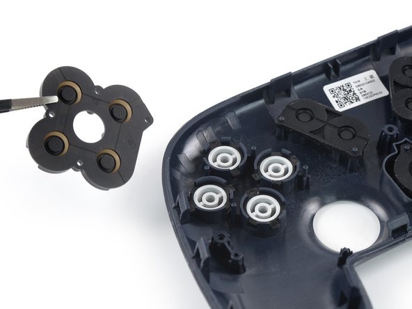

    3. Google Stadia Controller Buttons Replacement, Remove the rubber gasket: passo 19, imagem 1 %32 Google Stadia Controller Buttons Replacement, Remove the rubber gasket: passo 19, imagem 2 %32
      Ferramenta utilizada neste passo:
      • Use a pair of tweezers or your fingers to remove the rubber gasket on the A, B, X and Y buttons.

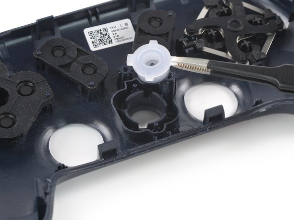

    6. Google Stadia Controller Buttons Replacement, Remove the buttons: passo 22, imagem 1 %32 Google Stadia Controller Buttons Replacement, Remove the buttons: passo 22, imagem 2 %32 Google Stadia Controller Buttons Replacement, Remove the buttons: passo 22, imagem 3 %32
      • Use a pair of tweezers to remove the menu and capture button.

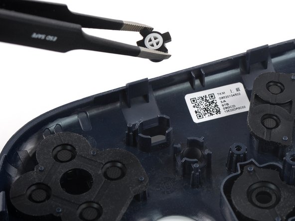

    8. Google Stadia Controller Buttons Replacement, Remove the button: passo 24, imagem 1 %32 Google Stadia Controller Buttons Replacement, Remove the button: passo 24, imagem 2 %32
      • Use a pair of tweezers to remove the Stadia button.

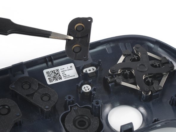

    9. Google Stadia Controller Buttons Replacement, Remove the rubber gasket: passo 25, imagem 1 %32 Google Stadia Controller Buttons Replacement, Remove the rubber gasket: passo 25, imagem 2 %32
      • Use a pair of tweezers or your fingers to remove the rubber gasket on the Google assistant and option button.

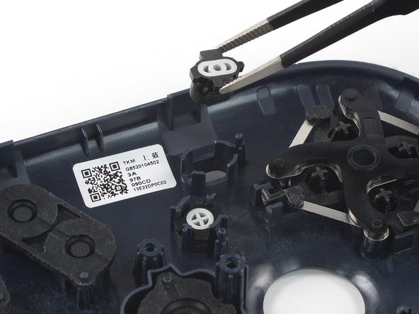

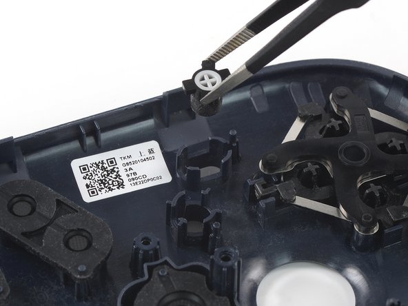

    10. Google Stadia Controller Buttons Replacement, Remove the buttons: passo 26, imagem 1 %32 Google Stadia Controller Buttons Replacement, Remove the buttons: passo 26, imagem 2 %32 Google Stadia Controller Buttons Replacement, Remove the buttons: passo 26, imagem 3 %32
      • Use a pair of tweezers to remove the Google assistant and option button.
