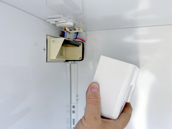

  4. GE Side-By-Side Refrigerator Fresh Food Thermistor Replacement, Remove damper cover: passo 4, imagem 1 %32 GE Side-By-Side Refrigerator Fresh Food Thermistor Replacement, Remove damper cover: passo 4, imagem 2 %32 GE Side-By-Side Refrigerator Fresh Food Thermistor Replacement, Remove damper cover: passo 4, imagem 3 %32
    • Remove the damper cover by pulling it straight out from the wall of the fresh food compartment.
    • It may take some persistence as the cover is held in place by a bracket mounted to the top of the compartment.
