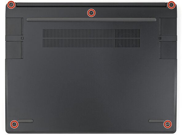

    • Use your Framework Screwdriver to loosen the five captive T5 Torx screws securing the Input Cover.

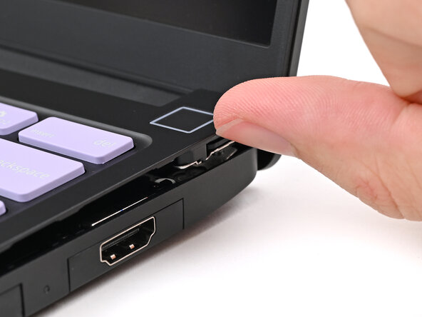

    • Flip over your laptop and open it.
    • Use your fingers to lift the Input Cover up and release it from its magnets.
    • Don't fully remove the Input Cover yet, as it's still attached by the Touchpad Cable.
    • If you're having trouble lifting the Input Cover, you can leverage the gap at the bottom right corner to get your fingers fully under it.

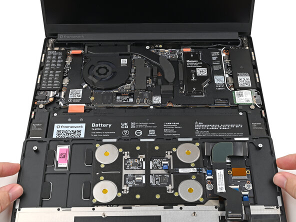

    • Flip the top of the Input Cover so the Keyboard is facing down.
    • Rest the Input Cover over the Battery, making sure the Touchpad Cable isn't being strained.

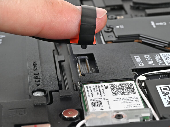

    • Insert your finger into the Touchpad Cable press connector loop.
    • Lift up to disconnect the Touchpad Cable from the Mainboard.

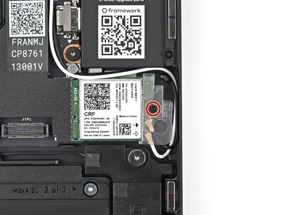

    • Use your Framework Screwdriver to loosen the captive T5 Torx screw securing the Wi-Fi module.
    • The module might pop up at a shallow angle when you loosen the screw.

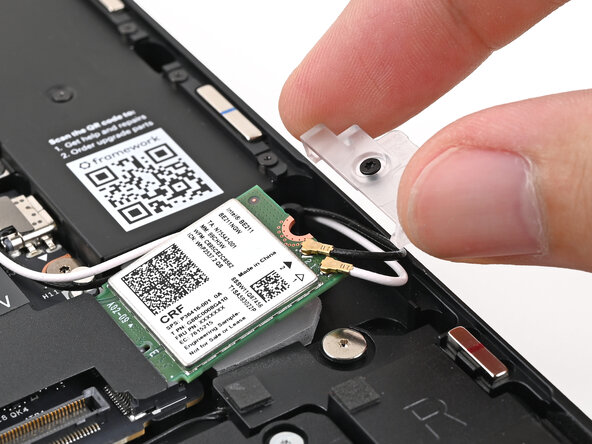

    • Slide the clear plastic cover straight off the module and remove it.
