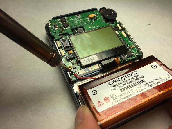

  5. Creative Nomad Jukebox Zen Battery Replacement: passo 5, imagem 1 %32 Creative Nomad Jukebox Zen Battery Replacement: passo 5, imagem 2 %32
    • Desolder both red and black wires coming from battery.
    • Como soldar e dessoldar contatos Use soldering gun with care as it becomes extremely hot and can cause burns.
    • Make sure to solder the black and red wires back into the same locations.
