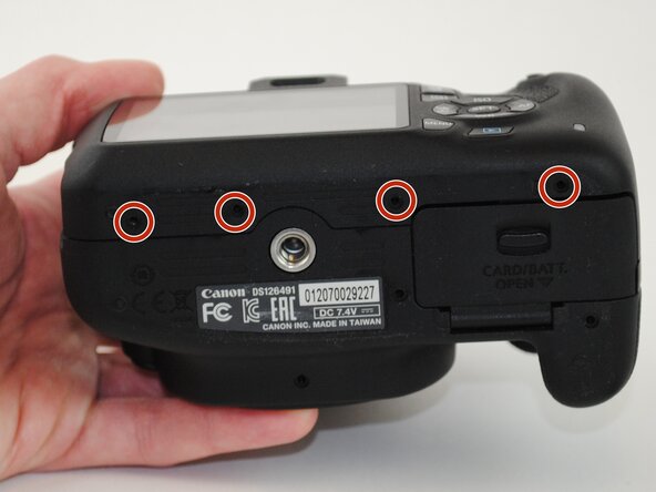

  5. Canon EOS Rebel T5 Image Sensor Replacement: passo 5, imagem 1 %32
    • Turn your camera so that the bottom is facing you.
    • Remove the four 5mm JIS #000 screws.
    Pergunte ao FixBot

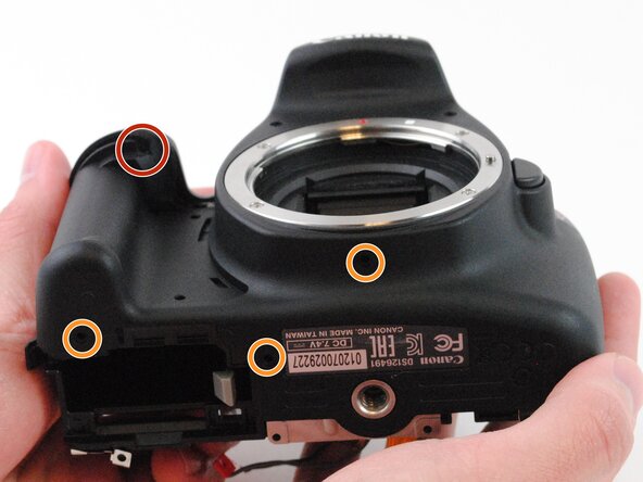

  11. Canon EOS Rebel T5 Image Sensor Replacement: passo 11, imagem 1 %32
    • Remove the black 5 mm JIS #000 screw, located under the grip.
    • Remove the three 3.5mm JIS #000 screws on the bottom of the case.
    Pergunte ao FixBot
    Comentar
