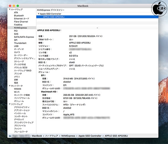

  10. MacBook Pro 13" Function Keys Late 2016 Teardown: passo 11, imagem 1 %32 MacBook Pro 13" Function Keys Late 2016 Teardown: passo 11, imagem 2 %32
    • Turning our attention to the very well-shielded SSD, we start by peeling up this massive patch of protective tape.
    • Per Apple, we know the SSD itself uses a high-speed PCIe-based interface—but this form factor and pin configuration look new.
    • Time to pry those shields off and see exactly what Apple cooked up here...
    • It's nice that Apple has kept their removable SSDs a first-out component, simplifying upgrades.

    Looks like a PCIe 3.0 x8?
    dicalp - Responder

    Will you ever find a compatible SSD on alternative market? Is it an option to buy the 256GB model and upgrade it by yourself?
    Emanuele io - Responder
    But it might indicate that Apple will offer an "upgrade"path in the future (Optane/XPoint when Intel figure out how to make it work? Yeah, I know, wishful thinking). Or could they stuff some other chip on that board? Instead of using 4 chips for the SSD, use two higher-density chips and put an M2 chip in the remaining space?

    From the information shown in the OS X, the SSD controller should be the same one used in the MacBook released early 2016. F4432ACPE-GD-F could be 4Gb LPDDR3 from Micron.

    JJ Wu -
    SSD controller inside Apple Macbook 2016. It is AP0256J.
    http://www.macotakara.jp/blog/archives/0...
    SSD controller in the Apple MacBook Pro 2016. It is also AP0256J.
    http://www.macotakara.jp/blog/macintosh/...
    The difference is PCIe lane numbers. In the MacBook 2016, it is 2-lanes PCIe 3.0 and it is 4-lanes PCIe 3.0 in the MacBook Pro 2016.
