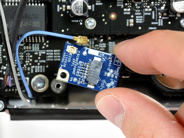

  7. iMac Intel 20" EMC 2266 Bluetooth Board Replacement, Bluetooth Board: passo 7, imagem 1 %32
    • Pull the Bluetooth cable straight away from its socket.
    • Pull the cable parallel to the face of the Bluetooth board.
  8. iMac Intel 20" EMC 2266 Bluetooth Board Replacement: passo 8, imagem 1 %32
    • Use the flat end of a spudger to pry the bluetooth antenna connector up off the bluetooth board.
  9. iMac Intel 20" EMC 2266 Bluetooth Board Replacement: passo 9, imagem 1 %32 iMac Intel 20" EMC 2266 Bluetooth Board Replacement: passo 9, imagem 2 %32
    • Remove the single T6 Torx screw securing the Bluetooth board to the logic board.
    • After removing this screw, the Bluetooth board is completely free from the logic board and may fall.
    • Lift the Bluetooth board out of your iMac.
