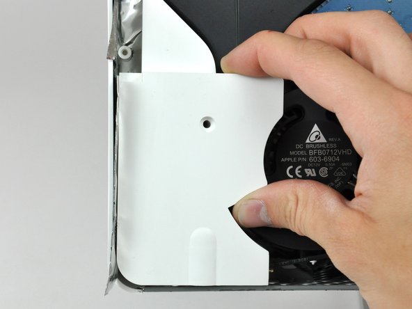

  17. iMac G5 17" Model A1144 CPU Fan Replacement: passo 17, imagem 1 %32
    • Pull the CPU fan connector up off its socket on the logic board.
  18. iMac G5 17" Model A1144 CPU Fan Replacement: passo 18, imagem 1 %32
    • Lift the CPU fan off the plastic posts protruding from the rear case.
