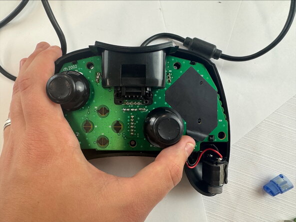

  3. XBOX Controller S Trigger Replacement, Trigger: passo 3, imagem 1 %32 XBOX Controller S Trigger Replacement, Trigger: passo 3, imagem 2 %32
    • Carefully remove the motherboard from the shell.

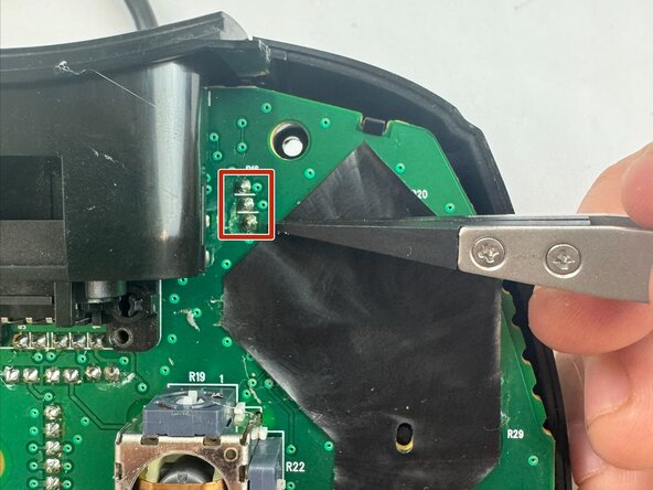

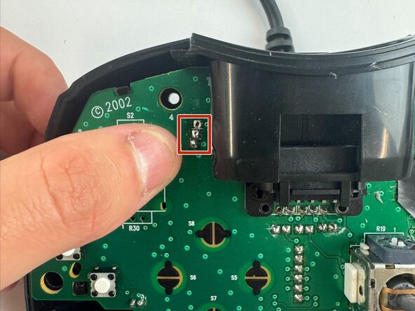

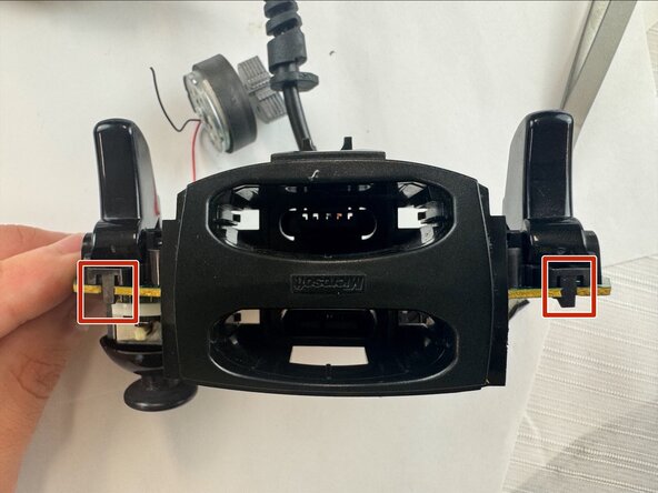

  4. XBOX Controller S Trigger Replacement: passo 4, imagem 1 %32 XBOX Controller S Trigger Replacement: passo 4, imagem 2 %32 XBOX Controller S Trigger Replacement: passo 4, imagem 3 %32
    • Desolder the three attachment points for the trigger, then unclip the trigger from the circuit board.
    • Clip in the new replacement trigger and solder the three attachment points.
