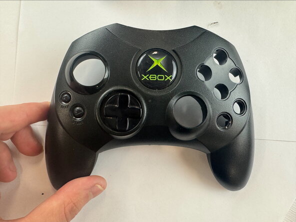

  2. XBOX Controller S Shell Replacement: passo 2, imagem 1 %32 XBOX Controller S Shell Replacement: passo 2, imagem 2 %32 XBOX Controller S Shell Replacement: passo 2, imagem 3 %32
    • Keep the controller facing down to prevent components from falling out.
    • Remove the back shell.
    • Flip the controller over and remove the front shell.
