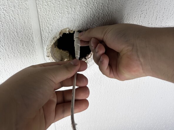

  3. Volisun 4-inch Recessed LED Light Replacement: passo 3, imagem 1 %32 Volisun 4-inch Recessed LED Light Replacement: passo 3, imagem 2 %32 Volisun 4-inch Recessed LED Light Replacement: passo 3, imagem 3 %32
    • Twist the cap counterclockwise.
    • Pull the cap up.
    • Disconnect the LED connector from the driver connection.
  4. Volisun 4-inch Recessed LED Light Replacement: passo 4, imagem 1 %32
    • Replace the old LED light with a new one.

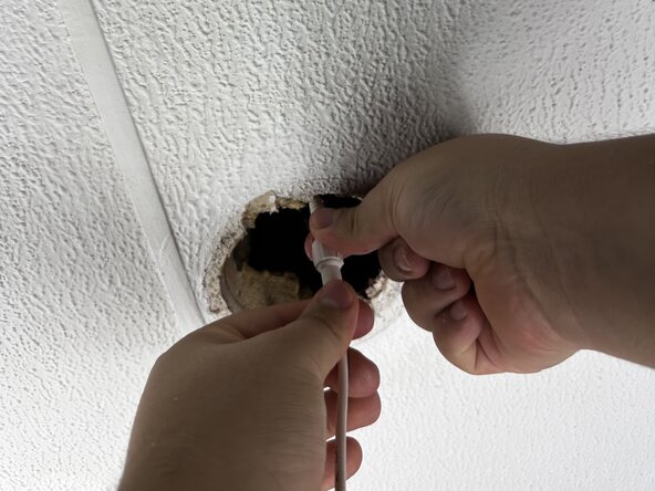

  5. Volisun 4-inch Recessed LED Light Replacement: passo 5, imagem 1 %32 Volisun 4-inch Recessed LED Light Replacement: passo 5, imagem 2 %32 Volisun 4-inch Recessed LED Light Replacement: passo 5, imagem 3 %32
    • Attach the new LED light connector to the driver connection.
    • Put the cap back.
    • Twist in a clockwise direction.
