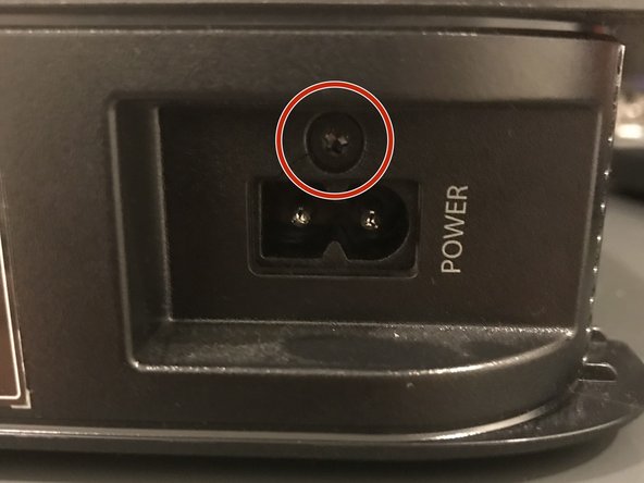

  2. Ubee DVW23C Power Supply Unit Replacement: passo 2, imagem 1 %32 Ubee DVW23C Power Supply Unit Replacement: passo 2, imagem 2 %32 Ubee DVW23C Power Supply Unit Replacement: passo 2, imagem 3 %32
    • Unscrew these 4 screws. All screws on this device are T10.
    • Then, flip over the device
