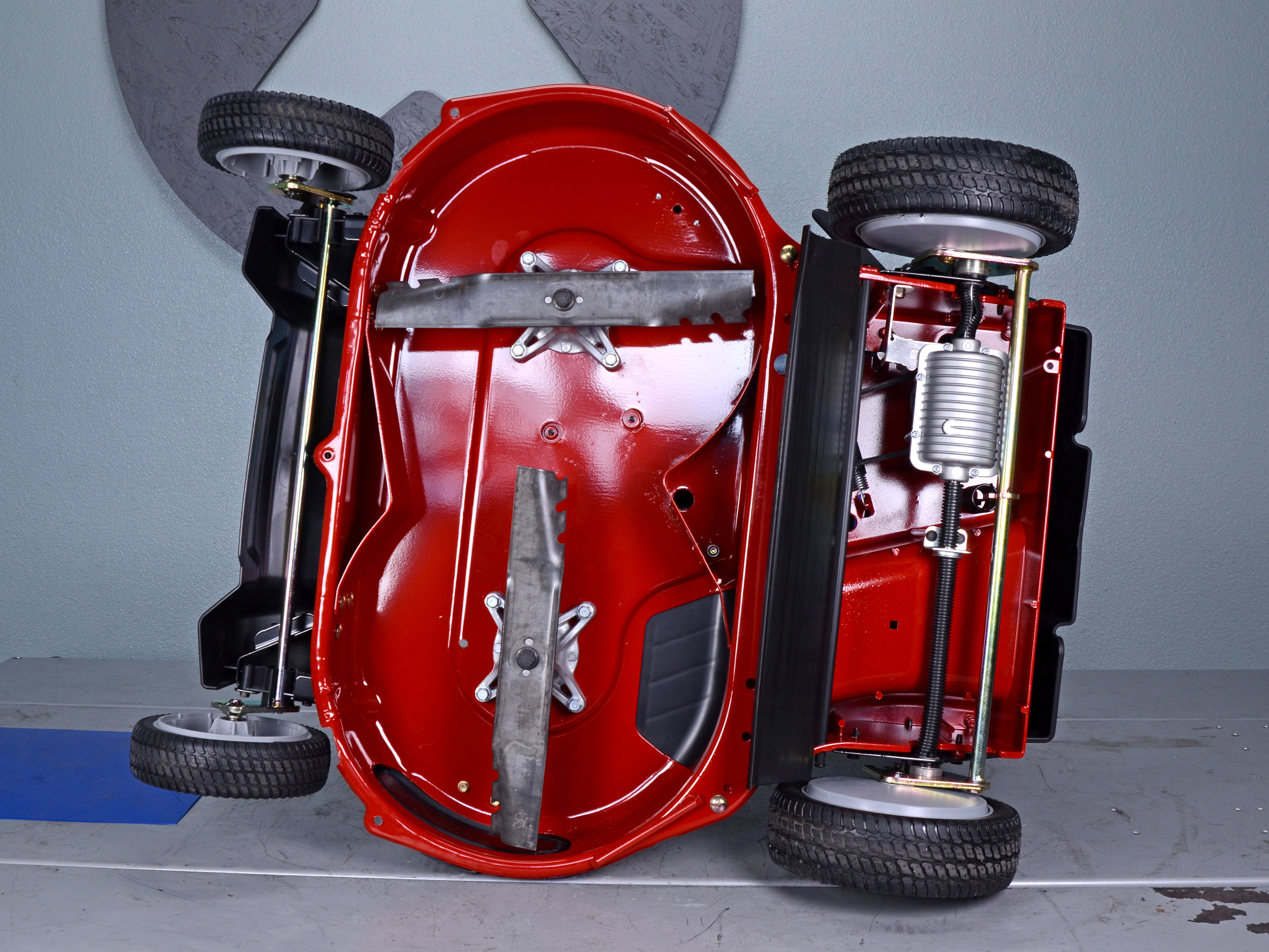

  5. Toro Walk Behind Mowers 21199HD 2018 Left Blade Replacement, Tilt the mower on its side: passo 5, imagem 1 %32
    • Tilt the mower onto its side so the blades are facing out.
    • This may require two people.
  6. Toro Walk Behind Mowers 21199HD 2018 Left Blade Replacement, Remove the blade bolt: passo 6, imagem 1 %32 Toro Walk Behind Mowers 21199HD 2018 Left Blade Replacement, Remove the blade bolt: passo 6, imagem 2 %32
    • Use an impact driver with a 5/8-inch socket to remove the left blade bolt.
    • If necessary, brace the blade with a screwdriver or extension by placing it in the hole in the metal blade guard.
