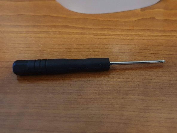

    • There is 1 screw that holds the cover plate in place. In order to open the housing you have to remove that screw.
    • The screw is hiding under the sticker. You can try to remove the whole sticker. I just scratched through with the spudger to expose the screw. (This voids your warranty!)
    • Remove the screw. I used a PH0 screw bit.

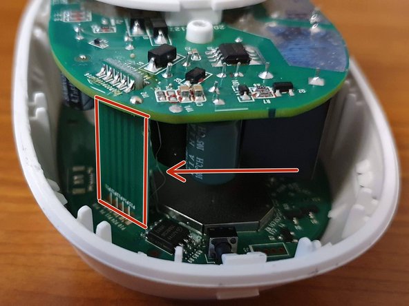

  5. TP-Link HS110 Disassembly: passo 5, imagem 1 %32 TP-Link HS110 Disassembly: passo 5, imagem 2 %32 TP-Link HS110 Disassembly: passo 5, imagem 3 %32
    • Finally, the internals are exposed. But be careful, it is very easy to break the whole circuitry!
    • There are 2 main PCBs inside on top of each other. Those are connected via a soldered mini "bus" PCB. The bottom one is screwed into the backplate via 2 little screws. You have to remove those to get the whole thing out without breaking it.
    • Unfortunately, the screwdriver in the Pro Tech Tool Kit did not fit into the small gap which leads to the screws. So I had to improvise with a small form factor screwdriver from a random HDD kit.

To repair the device, you must replace the capacitor C4 = 470 mf 16V that you see on the back of the the red arrow on step 5.
If you check, it have a bulge on the top, on my device happened the same, now it works.
