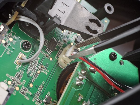

  6. SteelSeries Stratus Duo Charging Port Replacement, Disconnect the battery cable: passo 6, imagem 1 %32 SteelSeries Stratus Duo Charging Port Replacement, Disconnect the battery cable: passo 6, imagem 2 %32 SteelSeries Stratus Duo Charging Port Replacement, Disconnect the battery cable: passo 6, imagem 3 %32
    • Use a pair of blunt nose tweezers to grab and lift the connector away from the motherboard.

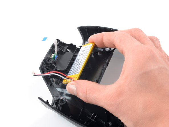

  8. SteelSeries Stratus Duo Charging Port Replacement, Pry up the battery: passo 8, imagem 1 %32 SteelSeries Stratus Duo Charging Port Replacement, Pry up the battery: passo 8, imagem 2 %32
    • The battery is held in place by mild adhesive.
    • Insert the long edge of an opening pick into the gap between the battery and the back cover assembly.
    • Take care not to puncture or bend the battery with your tool—a punctured or bent battery may leak dangerous chemicals or cause a fire.
    • Use the opening pick to carefully pry up the battery and separate the adhesive.
  9. SteelSeries Stratus Duo Charging Port Replacement, Remove the battery: passo 9, imagem 1 %32 SteelSeries Stratus Duo Charging Port Replacement, Remove the battery: passo 9, imagem 2 %32 SteelSeries Stratus Duo Charging Port Replacement, Remove the battery: passo 9, imagem 3 %32
    • Grab the battery with your fingers and lift it out of its recess to remove it.
    • Do not reinstall a damaged or deformed battery, as doing so is a potential safety hazard.
