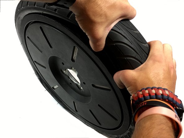

    • After the tire has been removed from the Segway body put the tire on a strong, level surface
  2. Segway i2 Inner Tube Replacement: passo 2, imagem 1 %32
    • Use the clamp to squeeze the rubber of the tire until the tire pops off of the rim. Repeat this process until the whole tire is popped off of the rim.
  3. Segway i2 Inner Tube Replacement: passo 3, imagem 1 %32
    • Use your hands to squish the tire all the way around the sides to make sure the tire is off the Segway rim completely.

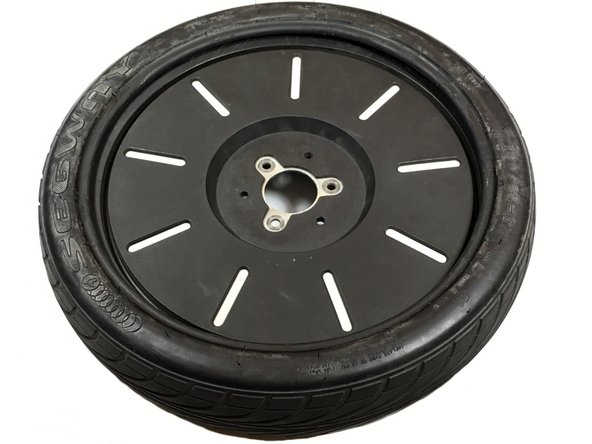

  4. Segway i2 Inner Tube Replacement: passo 4, imagem 1 %32 Segway i2 Inner Tube Replacement: passo 4, imagem 2 %32
    • (a) Now that the tire is popped off of the rim, use the persuasion bar to get under the rubber of the tire and put it over the rim. (b) When you pull the rubber of the tire over the rim be sure to push the persuasion bar towards the opposite side of the tire.
    • If the rubber is not going over the rim, verify that steps 2 and 3 have been completed and the tire is completely popped off of the rim.

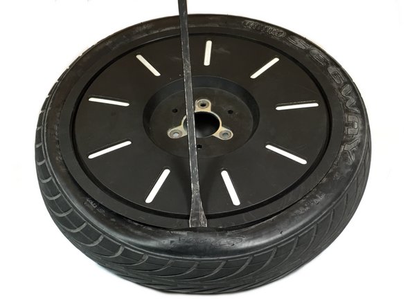

  5. Segway i2 Inner Tube Replacement: passo 5, imagem 1 %32
    • Using the flathead screwdriver, wedge it between the rubber and the rim to prevent the tire from returning to its original position.
