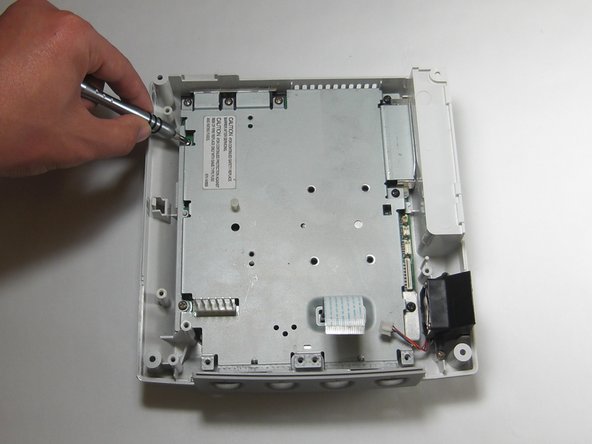

  20. Sega Dreamcast Logic Board Replacement, Logic Board: passo 20, imagem 1 %32 Sega Dreamcast Logic Board Replacement, Logic Board: passo 20, imagem 2 %32 Sega Dreamcast Logic Board Replacement, Logic Board: passo 20, imagem 3 %32
    • Remove the five 10mm Philips #02 screws from left side of the logic board cover.
    • Remove the three black 12mm Philips #02 screws from the right side of the logic board cover.
  21. Sega Dreamcast Logic Board Replacement: passo 21, imagem 1 %32 Sega Dreamcast Logic Board Replacement: passo 21, imagem 2 %32 Sega Dreamcast Logic Board Replacement: passo 21, imagem 3 %32
    • Lift the metal cover from the console.
