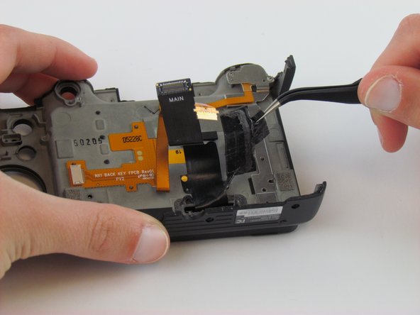

  4. Samsung NX1 LCD Touch Screen Replacement: passo 4, imagem 1 %32 Samsung NX1 LCD Touch Screen Replacement: passo 4, imagem 2 %32
    • Use the Phillips #00 screwdriver to remove the two 5.5 mm screws from the right side of the camera above the SD card port.
  5. Samsung NX1 LCD Touch Screen Replacement: passo 5, imagem 1 %32
    • Use the Phillips #00 screwdriver to remove one 5.5 mm screw on the left, above the HDMI port.
  6. Samsung NX1 LCD Touch Screen Replacement: passo 6, imagem 1 %32
    • Use the Phillips #00 screwdriver to remove the five 5.5 mm screws from the bottom, near the battery compartment.
    • Use the Phillips #00 screwdriver to remove one 3.8 mm screw from the bottom of the hand grip, below the battery compartmen.
  7. Samsung NX1 LCD Touch Screen Replacement: passo 7, imagem 1 %32 Samsung NX1 LCD Touch Screen Replacement: passo 7, imagem 2 %32 Samsung NX1 LCD Touch Screen Replacement: passo 7, imagem 3 %32
    • Use a plastic opening tool to separate the back cover from the front cover.
    • Pry the back cover in this order: bottom, right side, left side.
  8. Samsung NX1 LCD Touch Screen Replacement: passo 8, imagem 1 %32 Samsung NX1 LCD Touch Screen Replacement: passo 8, imagem 2 %32
    • Use your fingers to pull the back cover away from the front cover.
    • Do not completely separate the back cover from the front cover as two cables hold these components together.
  9. Samsung NX1 LCD Touch Screen Replacement: passo 9, imagem 1 %32 Samsung NX1 LCD Touch Screen Replacement: passo 9, imagem 2 %32 Samsung NX1 LCD Touch Screen Replacement: passo 9, imagem 3 %32
    Ferramenta utilizada neste passo:
    • Use tweezers to pull the two ribbon cables horizontally out of their clips.

Thanks! This guide is missing some steps and details once you open it up, but it was enough for me to get the job done. Thank you.
Once inside be super careful with the ribbon cables. One slides out the side and the cable labeled “Main” pops off the top. At first I thought I broke the Main cable. You’ll need to unhood the main cable from the frame before you can detach the LCD… and the LCD is glued on airtight to the articulating frame.
