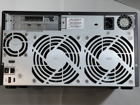

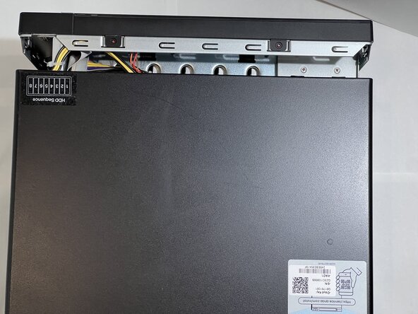

  2. QNAP TVS-h874T RAM Replacement: passo 2, imagem 1 %32 QNAP TVS-h874T RAM Replacement: passo 2, imagem 2 %32 QNAP TVS-h874T RAM Replacement: passo 2, imagem 3 %32
    • Turn the QNAP with the back facing upwards so it is easier to access the screws.
    • Use a #2 Phillips screwdriver to remove the three 3.9 mm screws that hold the black cover to the back.
    • These are the only screws that need to be removed for the entire process.
    • Do not remove any other screws. The other screws hold the fans to the case, and the drive bay supports together.

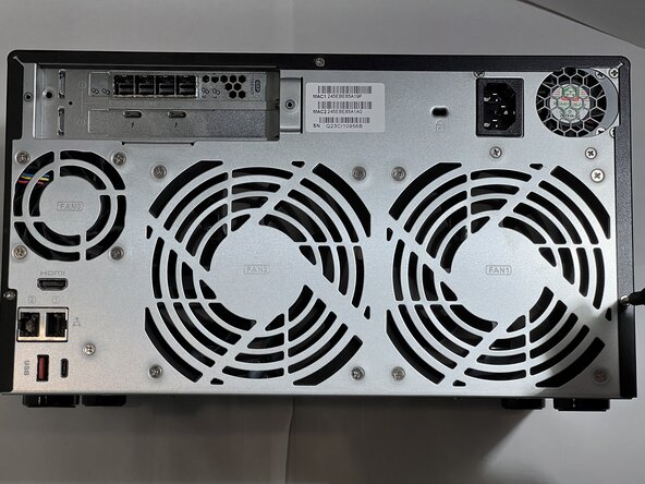

  3. QNAP TVS-h874T RAM Replacement: passo 3, imagem 1 %32 QNAP TVS-h874T RAM Replacement: passo 3, imagem 2 %32 QNAP TVS-h874T RAM Replacement: passo 3, imagem 3 %32
    • Turn the QNAP so the back is facing you.
    • Gently press on both sides of the cover at the rear and slide the cover towards the you.
    • The cover should slide on and off with minimal force.
    • When reassembling ensure that the bottom and sides of the cover align with the body of the case.
    • Once the cover is free of the front bezel, it can be lifted off.

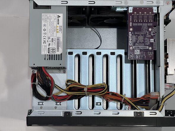

  4. QNAP TVS-h874T RAM Replacement: passo 4, imagem 1 %32 QNAP TVS-h874T RAM Replacement: passo 4, imagem 2 %32
    • With the cover off you can see:
    • The power supply and power connectors
    • Any installed PCI cards
    • The motherboard is mounted vertically on the left side if you are facing the rear of the QNAP.
    • Turn the device onto the right side if you are facing the rear of the QNAP.

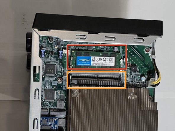

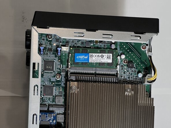

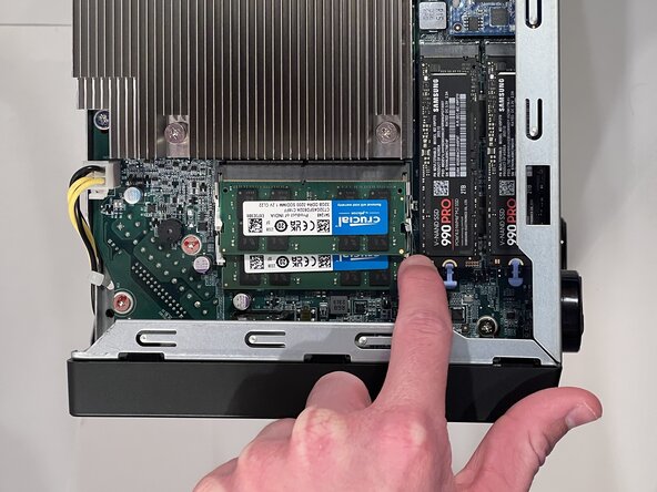

  5. QNAP TVS-h874T RAM Replacement: passo 5, imagem 1 %32 QNAP TVS-h874T RAM Replacement: passo 5, imagem 2 %32 QNAP TVS-h874T RAM Replacement: passo 5, imagem 3 %32

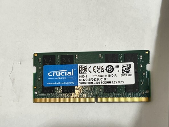

    • With the motherboard facing up, you will see 2 DIMMS for RAM.
    • If the NAS has 16GB of RAM you will want to install either (1) 16GB DIMM or replace the existing DIMM with (2) 32GB DIMMS.
    • Please check the QNAP Memory compatibility site to ensure you have DIMMS that will work.
    • This NAS has a single 32GB DIMM installed.
    • The new DIMM will go into the empty slot.
    • If you need to remove a damaged RAM chip, use your fingers to pull the metal arms on both sides of the RAM away enough to release it.
    • The RAM will pop up by a few millimeters.
    • Remove it at an angle and not straight up so you don't damage the socket.

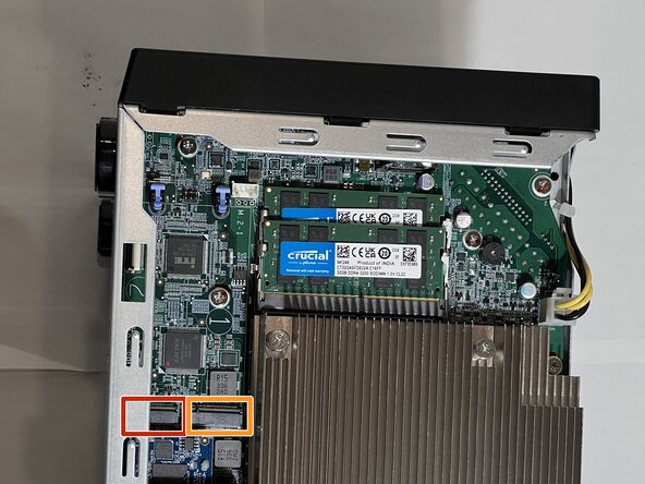

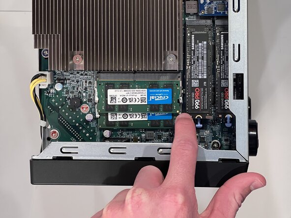

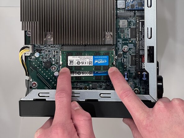

  6. QNAP TVS-h874T RAM Replacement: passo 6, imagem 1 %32 QNAP TVS-h874T RAM Replacement: passo 6, imagem 2 %32 QNAP TVS-h874T RAM Replacement: passo 6, imagem 3 %32
    • To insert the RAM, align the pins with the slot.
    • The DIMM has a single slot that allows it to only be inserted one way. Ensure the slot in the DIMM is aligned with the divider in the slot.
    • Insert the DIMM at a 45° angle.
    • The DIMM should slide in easily so don't force it. If it does not slide in, make sure the DIMM is aligned with the guide in the socket.
    • Gently press on both corners to lower it into the retaining clips.
    • Do not press hard, the DIMM should snap in without very much pressure. Too much pressure may damage the retaining clips on the sides.
