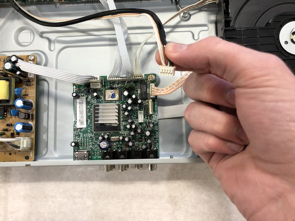

With constant use, the USB port can become broken or unresponsive. This guide will show you how to replace the USB port on your Philips DVP5992-F7.
O que você precisa
Remove the three 6.4 mm Phillips #1 screws on the back of the device with a Phillips head screwdriver.
Remove the 6.4 mm Phillips #1 screws on each side of the device.
