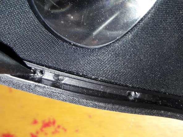

    • This part really is tricky. I assume they are many way to do it, here is the one I figured out.
    • Once the outside frame is released (as seen in previous steps), you may pull this frame to see one of the six clips. As shown in picture 1.
    • Using the nose shape you are able to slide an opening tool under this clip.
    • The position of the opening tool is shown on the first picture.
    • On the second picture I tried to show how the opening tool is able to slide under the clip (highlighted in green)
    • It is not easy to access. Therefore it is not easy to do. I also is not easy to take a picture of. So I added the third picture, hopefully you may see what you need on one of them.
    • Once the first clip is released, the other ones are easier to access.

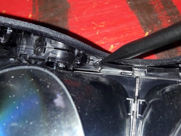

  10. Oculus Rift CV1 - open it, Release three additional tiny screws: passo 10, imagem 1 %32 Oculus Rift CV1 - open it, Release three additional tiny screws: passo 10, imagem 2 %32 Oculus Rift CV1 - open it, Release three additional tiny screws: passo 10, imagem 3 %32
    • There are at least two tiny screws that are holding the electronic frame to the google. You can see them on pictures 1 and 2.
    • And another one that is holding the lens button you will need to remove in the next step. You can see it on picture 3
    • I used T3 torx screwdriver to release them.

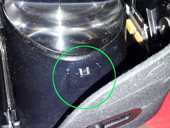

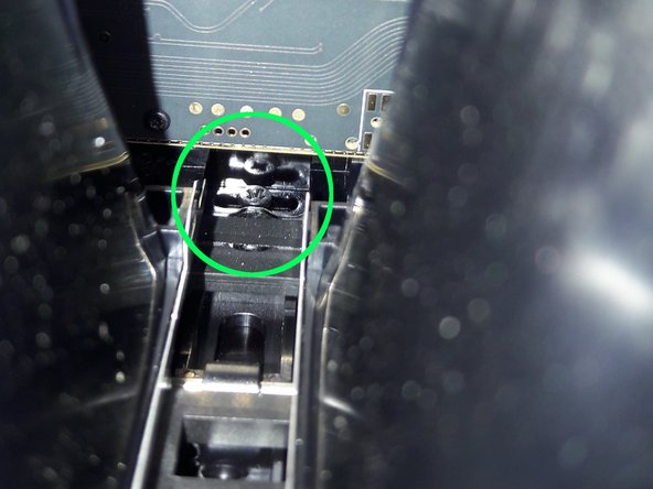

  12. Oculus Rift CV1 - open it, And now I fail to remove the last screw: passo 12, imagem 1 %32 Oculus Rift CV1 - open it, And now I fail to remove the last screw: passo 12, imagem 2 %32 Oculus Rift CV1 - open it, And now I fail to remove the last screw: passo 12, imagem 3 %32
    • At this stage, you will almost be able to release the electronic frame from the googles (see picture 1).
    • But on the upper side of the googles there is one inaccessible screw I don't know how to reach (see pictures 2 and 3)
    • If someone knows how to do that, please reach me, I'll push this tutorial further

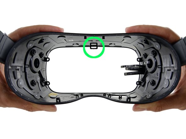

  13. Oculus Rift CV1 - open it, Checking that it's a failure: passo 13, imagem 1 %32 Oculus Rift CV1 - open it, Checking that it's a failure: passo 13, imagem 2 %32
    • As you can see, sliding an opening tool between the electronic frame and the googles, confirms that there is something to release at the place where this screw is.
    • On this other borrowed picture (picture 2) we can see there is a socket for either the screw I cannot remove or a clip I do not understand.
