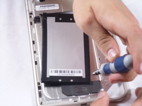

  11. Nook Tablet Battery Replacement, Taking Out the Battery: passo 11, imagem 1 %32 Nook Tablet Battery Replacement, Taking Out the Battery: passo 11, imagem 2 %32 Nook Tablet Battery Replacement, Taking Out the Battery: passo 11, imagem 3 %32
    • Set aside the motherboard and focus on the metal backing containing the battery.
    • Use the screwdriver or plastic prying tool around the edges of the battery to pry it from its slot in the metal backing.
    • The battery may be held with adhesive. Do not panic if it feels like you are prying too hard just apply careful force until it is no longer stuck.
    • Pick up the battery and remove it making sure to free the cords in the upper left hand corner by sliding it out rather than lifting it.
