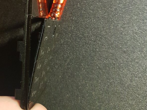

  5. Nokia 515 Front cover and keypad replacement, Remove the keypad: passo 5, imagem 1 %32 Nokia 515 Front cover and keypad replacement, Remove the keypad: passo 5, imagem 2 %32 Nokia 515 Front cover and keypad replacement, Remove the keypad: passo 5, imagem 3 %32
    • To remove the keypad, you should use the spudger to push the top clamps down a little bit while pressing your fingers against the inside of the keypad.
    • The keypad should be loose at the top.
    • To remove the bottom, just use a little bit of force to pull it off the front panel.
    • Just use a little bit of force.
