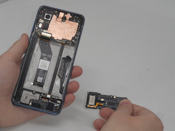

  10. Motorola Moto G Stylus 4G (2023) Charging Port Replacement: passo 10, imagem 1 %32 Motorola Moto G Stylus 4G (2023) Charging Port Replacement: passo 10, imagem 2 %32
    • Remove the speaker using an ESD-safe spudger.
