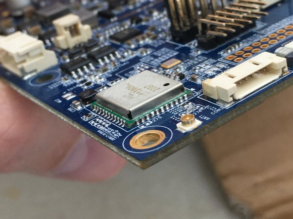

  1. Meural Canvas MC227 Wi-Fi Module Replacement, Remove the rear cover, locate the mainboard.: passo 1, imagem 1 %32 Meural Canvas MC227 Wi-Fi Module Replacement, Remove the rear cover, locate the mainboard.: passo 1, imagem 2 %32 Meural Canvas MC227 Wi-Fi Module Replacement, Remove the rear cover, locate the mainboard.: passo 1, imagem 3 %32
    • Remove all the philips screws off the rear cover.
    • Approach the mainboard, remove all the connectors and the screws and free the mainboard.
    • Wi-Fi module is shown in the last photo, it is AP6255.
    • You need to desolder the Wi-Fi module and replace it.
