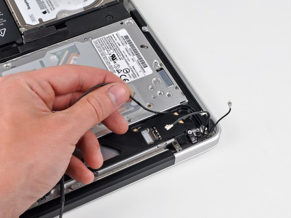

    • Pry the AirPort and Bluetooth antenna connectors (3 total) up off the AirPort/Bluetooth board.
  7. MacBook Pro 15" Unibody Mid 2010 AirPort/Bluetooth Board Replacement: passo 7, imagem 1 %32 MacBook Pro 15" Unibody Mid 2010 AirPort/Bluetooth Board Replacement: passo 7, imagem 2 %32
    • De-route all three antenna cables from their channels in the black plastic AirPort/Bluetooth housing.
  8. MacBook Pro 15" Unibody Mid 2010 AirPort/Bluetooth Board Replacement: passo 8, imagem 1 %32 MacBook Pro 15" Unibody Mid 2010 AirPort/Bluetooth Board Replacement: passo 8, imagem 2 %32
    • Remove the two Phillips screws securing the AirPort/Bluetooth board housing to the upper case.
    • Carefully remove the AirPort/Bluetooth assembly from the lower case.
