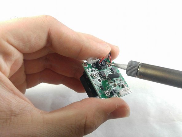

  4. Lorex MC6950 Circuit Board Replacement: passo 4, imagem 1 %32 Lorex MC6950 Circuit Board Replacement: passo 4, imagem 2 %32
    • Now the motor, lens, and wires must be removed from the circuit board. There are three 5mm JIS 0 screws located on the lens side of the circuit board to remove the motor housing.
    • The motor housing will need to be soldered back onto the new circuit board when reassembling. The wires should come from the circuit board and connect to the motor housing on the opposite of the lens side of the circuit board.
  5. Lorex MC6950 Circuit Board Replacement: passo 5, imagem 1 %32
    • The lens has two 5 mm JIS 0 screws located under the motor's previous location.
    • As a final step, the wires that connected the board to the containment shell will need to be removed from the board.
    • The lens should be the first component placed when reassembling the camera
